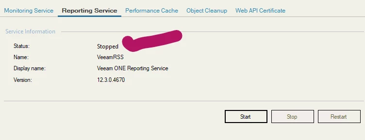

Hi Community,
I’m facing an issue where Veeam ONE Reporting Service (VeeamRSS.exe) cannot communicate with Veeam ONE Monitoring Service (VeeamDCS.exe).
The error message states:
The Monitoring service appears to be stopped or inaccessible. Has anyone encountered this before?
  • What could cause the Monitoring service to become unavailable?
Any insights or best practices to resolve this would be greatly appreciated. Kindly note that support case already been open for this.

  • October 26, 2025
Hi ​@Chris.Childerhose
Currently application version is 12, and I tried to upgrade to version 13, but it failed during the upgrade. I checked the error logs did not find anything. What happened after the failed error application was not upgraded, but its database was upgraded to version 13. I think so, that's why this error comes, and right now I'm not able to connect to the DB as well because of a version compatibility issue with the DB

  • October 26, 2025
That is the problem.  you upgraded the database to 13 and the version is still 12.   Did you take a snapshot before the upgrade to revert back to?   Do you have a previous backup that you can reinstall to v12 and restore the database from?   I always take a snapshot before upgrading.

  • October 27, 2025
Yes, I have a lot of old restore points, and yesterday, support was with me during the session, and we performed a restore using the old restore point to restore the VM. Still, again, it took a new DB version instead of the old DB version. He said I have escalated this case to the next tier of team, and logs have already been sent to support and are waiting for the response.

  • October 28, 2025
from my point of view is issue with connection or reporitng database is down
did you try to connect from VONE server to the database via another tools like sql studio?
I try it is connected with SQL Studio but not connected with the Veeam One Settings utility.
waqasali
Forum|alt.badge.img+4
  • Author
  • On the path to Greatness
  • October 28, 2025
I have exported.BAK file and gave it to the DB admin, he replaced the DB from his side, and now it is coming up and running and working as expected with the previous version.
