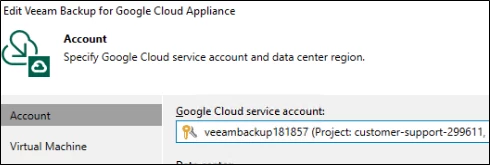

Hi ​@Reba
First review and make sure that all necessary permissions are correctly assigned both at the project level and directly to the Service Account. These permissions should be provisioned from the GCP IAM settings to enable smooth and uninterrupted operations.
Check all these should be successful:

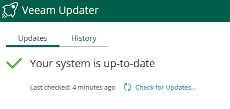

Hi ​@waqasali ! I understand your point... I'm trying to perform the update from the VBR and not from the appliance as you show in the screenshot.
When the appliance is connected to the VBR, it's not possible to perform the update directly from GCP, or at least it doesn't display the Veeam updates. It does show updates for the operating system, .NET, PostgreSQL, etc
Configuration-> Support Information-> Available updates
On the other hand, regarding the permissions... What I saw in the log is that it creates a temporary user to apply the upgrade, but this user isn't configured anywhere on the appliance or the VBR.
veeam-backup-gcp-vm: Service account veeam-1748633483-sa has been created successfully...
Clearly, this user doesn't have permissions, and on each update attempt, it uses a different one, making it impossible to grant the necessary permissions.

Hi ​@Reba
I would like to clarify that there are two different types of updates involved here. From the screenshot you shared, it appears that the updates you're referring to are from the Web UI interface. These updates are received periodically through the interface and are not related to the appliance upgrade process via the Veeam Backup & Replication (VBR) console.
However, the issue you're facing is specifically with upgrading the appliance from the VBR console, which seems to be encountering errors or failing to complete. This is a separate process from the Web UI updates.
For more information please check my latest topic which i post already and might be it is helpful for you.

Hello everyone,
Good news! We've successfully completed the upgrade.
Here are some key takeaways from the migration:
  • Logs: For tracking the upgrade, check the logs located at: C:\ProgramData\Veeam\Backup\Plugins\GCP\Logs\"Appliance Name"\Update.log. They provide excellent detail.
  • Required Permissions: Ensure the service account configured in the VBR has all the necessary permissions as outlined here: https://helpcenter.veeam.com/docs/vbgc/guide/plugin_permissions.html?ver=6
  • Firewall Configuration: You'll need to enable ports 22 and 443 via a public IP. This firewall rule must be applied to the appliance using a network tag prior to initiating the upgrade.
