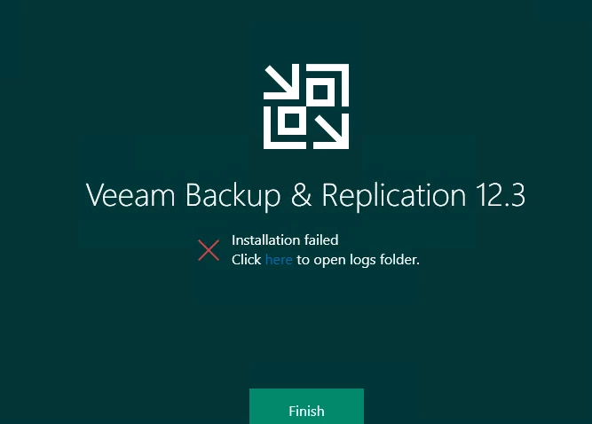

I am attempting to upgrade Veeam backup and replication but I get an installation failure.
Error    Failed to start service 'Veeam Backup Service' after installing package VeeamBackupSvc.msi
Error    MSI package: VeeamBackupSvc.msi returned error code: 1603
What could be causing the service start failure and m.si error code 1603?

You will need to go through the logs but is the database service running?  Postgres or SQL?
This needs to be running before Veeam will start.  If the logs don't help I would suggest a support ticket as that is the best route with these types of issues.

Thanks for your reply. All services automatically stops during the upgrade. Could the install failure be related to outdated .net?

That is possible but the installer checks the pre-reqs and would update it since it is included in the ISO file.  You could try manually updating and then upgrading again.
Worst case scenario is uninstall the application and then reinstall it pointing it back to your DB in the process so it uses it again.  That has worked for me when I get stuck.  😂

Hi, please to restart service. Will work? If not check user account under , which is running. Another help. You can try to open certmgr.msc and delete VBR certificates. Reboot and start to upgrade again.

Found the issues.
  1. .net framework was outdated and had to update to the latest version causing error 1603.
  1. Veeam setup has issues starting some Veaam services.
The main issue was that the update would not run if any Veeam services were running. I had to stop each one individually and set them all to manual startup. The Veeam setup would fail to automatically start these servers so i had to start them myself.
The upgrade ran fine thereafter and I re-enabled the services to start automatically.
