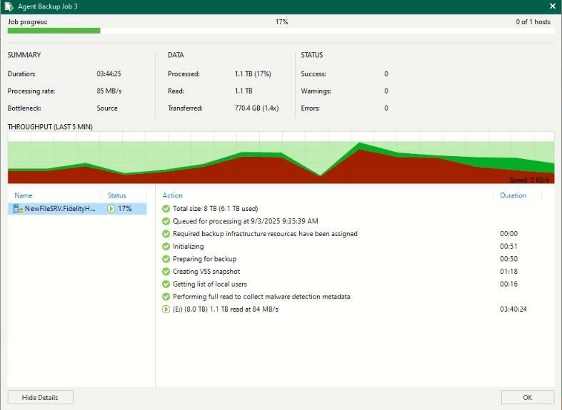

I am facing performance speed issues with the agent backup. The server capacity is 8TB, and it takes a very long time to complete the backup. Could you please advise if there are any solutions or recommendations to increase the
backup speed?

Hello,
Performance issues with large servers during Agent backups are usually related to bottlenecks in one or more areas, Storage Performance Network bandwith, Job mode, parallel processing, compression.
Based on the image you shared, the bottleneck is on the Source. This means the main limitation is on the protected server side. You can check disk performance, CPU/Memory usage, concurrent workloads.

Hello,

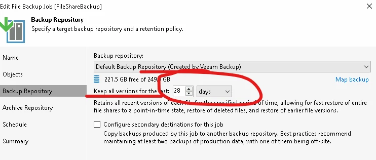

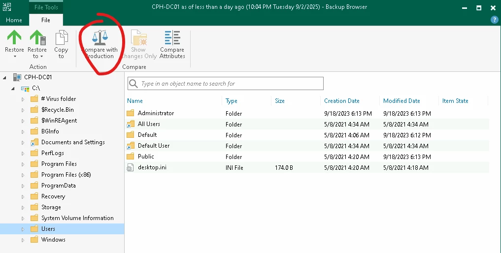

​@alikhazem Do you need versioning? like this:
I’m asking this because if dont need versioning, I’ll recommentd you to take image level backup instead of file backup, it is much, much faster, and to resotre, yuo can leverage IFLR, on v12, you can also use de compare feature, such this.
how many files do you have on your fileserver?
Could you please share your file backup job?
