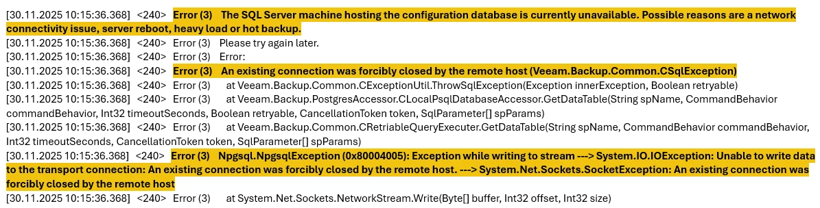

Do you use config generated by veeam for psql db  in postresql.auto.conf?
Normally issue is if psql db is not properly set, it could stuck
Second issue is if SSL communication in pg_hba.conf is not set, then could stuck.
Did you checked postgresql log file?

Check the PostgreSQL logs to identify if any DB issues C:\Program Files\PostgreSQL\15\data\log

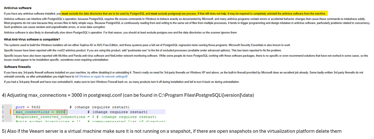

the below i share answer

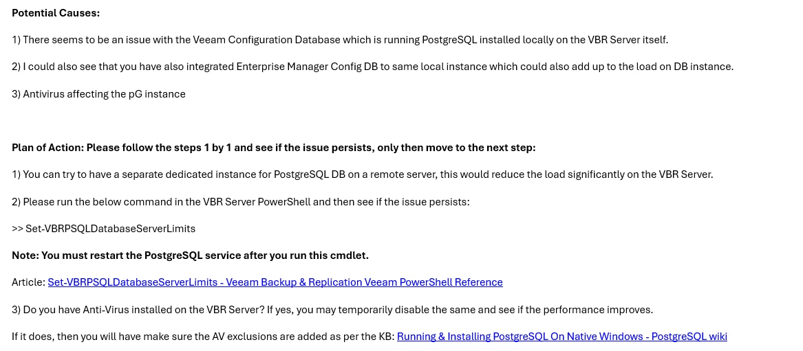

  • December 9, 2025
Below are a few thoughts on the same:

Almost all of my VBR configuration is already aligned with the mentioned points. For the remaining items, I have made adjustments according to the feedback provided after support email.

Hi ​@waqasali,
i would suggest to follow this KB article
it will create dump and then postgresql.auto.conf
then please go to the pg_hba.conf and set hostssl for communication with veeam
max_connection and work memory increase is not enough

3rd thing what was done from my side was to provide exclude list for antivirus for postgresql
as veeam is using new connection for each request, it happened, that cpu was on 99% and connection on port was unresponsive of database

i informed my security team must exclude the data directories that are to be used by PostgreSQL and must exclude the postgresql.exe process.
