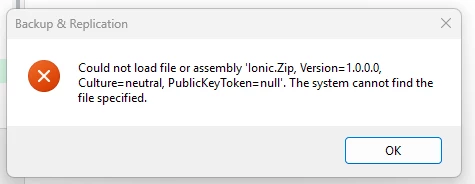

The Veeam Console ‘Create Windows Deployment Kit’ option isn’t functioning and throws the error below.

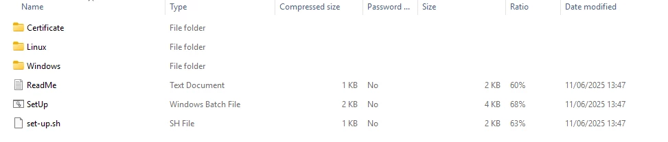

If done through the web GUI you’ll get a zip file which after extracting on the HV host will give you the following folder structure.

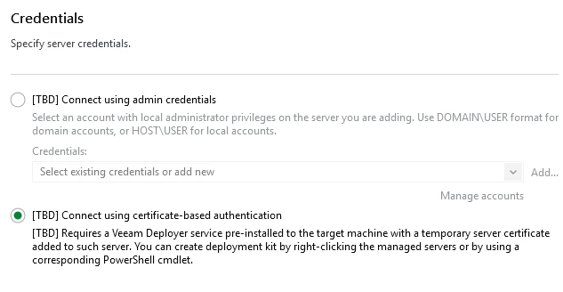

Running SetUp.bat deploys the installer service and OpenSSL and then imports the certificate.  Once done, in the Veeam Console or web UI a server can be added as long as the method is ‘Connect using certificate-based authentication’ as shown below.
