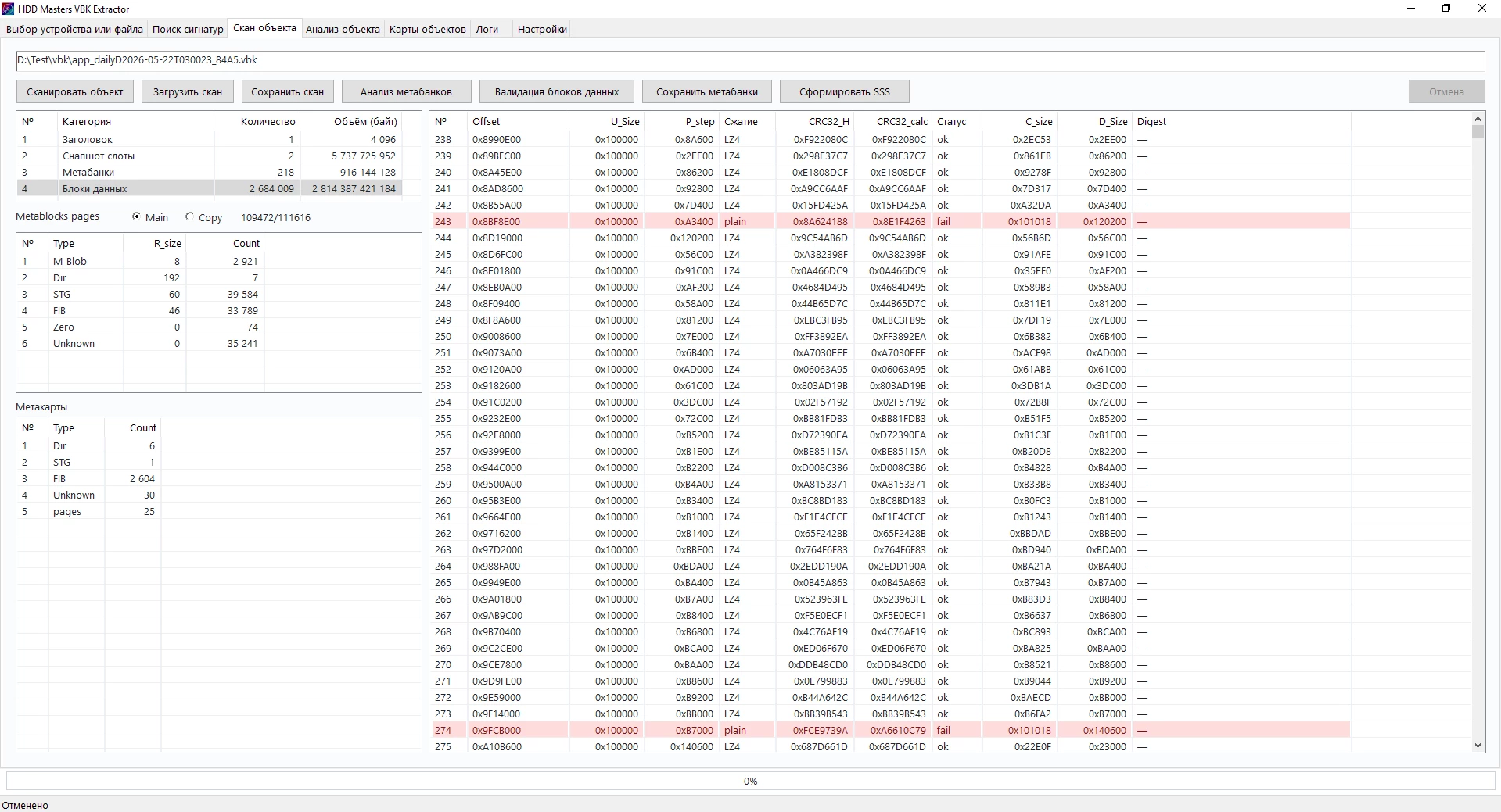

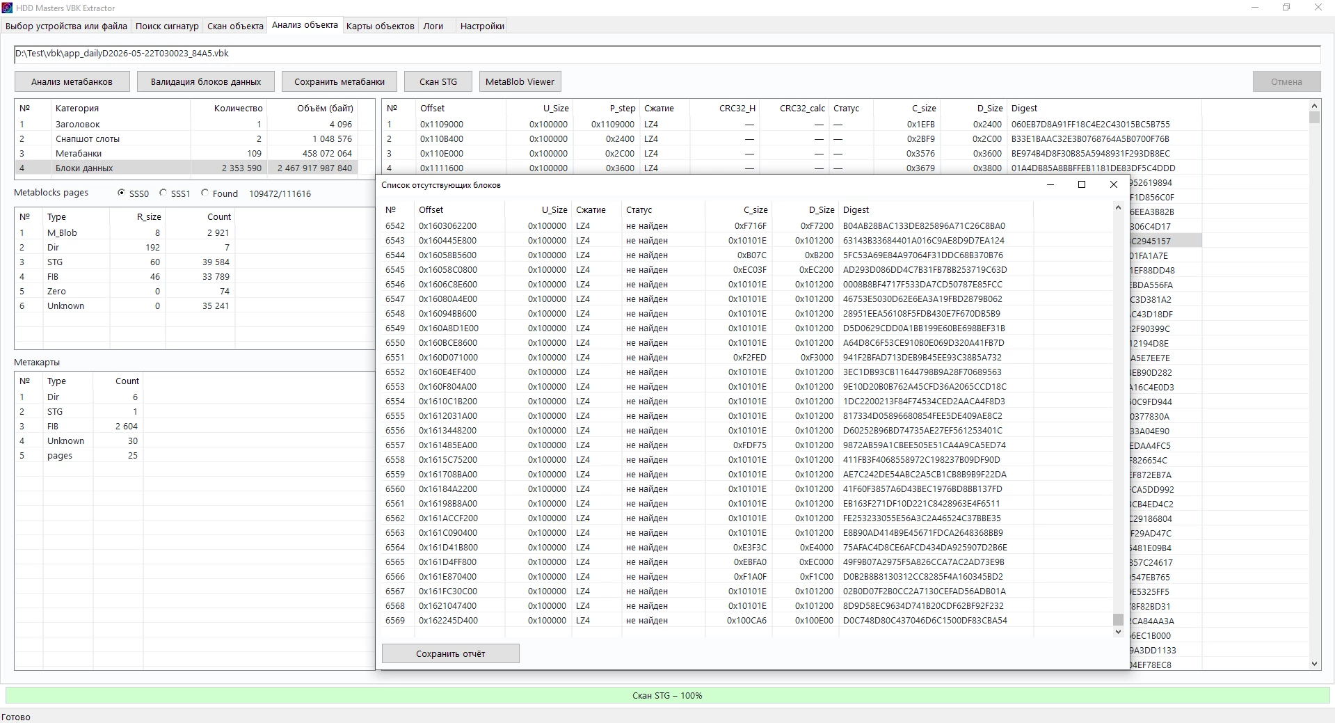

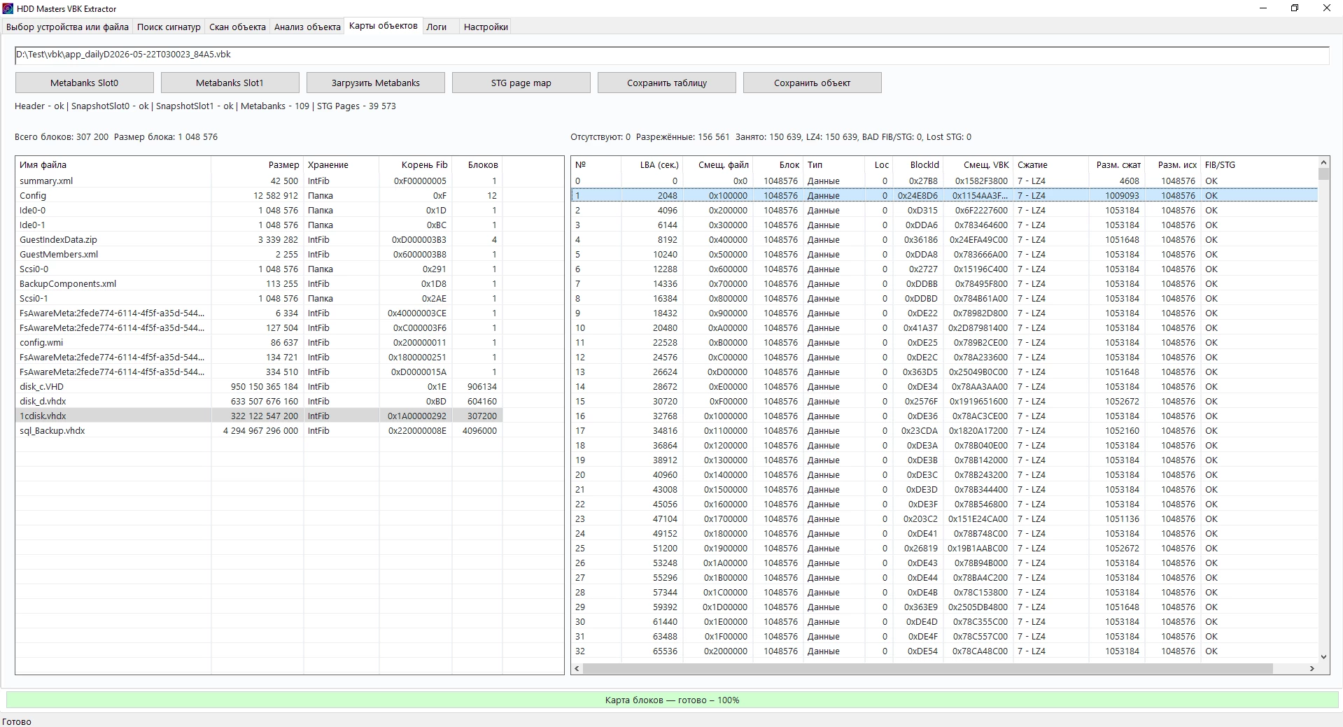

I wanted to share some technical insights regarding VBK file structure and recovery, specifically for versions 12 and 13.
In the first megabyte of the file, you won't just find the standard header. The most critical components located there are Snapshot Slot 0 and 1, which contain the metabank tables (descriptors).
Recently, I developed an alpha version of an in-house data recovery utility to solve a specific case: extracting data from a corrupted VBK file that had been partially encrypted by ransomware at specific intervals.
The recovery workflow came down to the following steps:
1. Signature-based carving: Searching for metabanks and data blocks using the 0F 00 00 F8 magic signature, followed by identifying LZ4-compressed payloads.
2. Filtering false positives: Discarding junk candidates and accurately identifying valid metabank copies.
3. Chain reconstruction: Building chains from the two metabank copies, correcting corrupted entries, and cross-referencing them via CRC validation to ensure consistency between the copies.
4. Bypassing native limitations: In my specific case, the stock Veeam Extract Utility failed to process a corrupted file record. It managed to parse the directories but aborted before even starting the actual extraction.
5. Structural analysis: Parsing the internal structures of the metabanks to build a lower-level block table (STG map). This mapped all blocks described by the metadata and cross-referenced them against the blocks actually found during the signature scan.
6. Object mapping: After assessing the block loss rate, I analyzed the directory and object trees, accounting for sparse block chains, to build a complete map of the packed objects.
7. Targeted export: The final data extraction was performed using this reconstructed map. In my scenario, where the block loss was around 1%, the data recovery result was highly successful.
A word of caution:
If only the first megabyte of your VBK is damaged, the recovery prognosis is likely favorable. However, keep in mind that most ransomware strains tend to encrypt more than just the file header. Since VBK files consist primarily of high-entropy compressed data, it is notoriously difficult to visually or programmatically spot other corrupted areas without deep structural validation.

7. Дальнейший экспорт велся по карте. В моем случае при работе с VBK, где потери составили около 1% блоков, получился весьма неплохой результат восстановления данных.
Если у вас поврежден только первый мегабайт, то прогнозы скорее всего благоприятные. Но большинство шифровальщиков все же склонны шифровать не только начало. В vbk, в основном сжатые данные и по энтропии проблематично заметить иные испорченные места.

This software is not intended for public distribution. It is a specialized instrumental platform designed specifically for analyzing damaged Veeam Backup files (VBK, VIB, VBR).
Effective use requires hands-on work by a qualified Data Recovery specialist who can visually distinguish between FIB and STG structures in a hex editor. As I tackle cases of varying complexity across different Veeam Backup versions, the platform's tools are continuously updated and patched on the fly during the actual recovery process. Therefore, it is not a ready-to-use end-user product.

I am posting this here so you can see that specialized laboratory tooling exists for recovering corrupted VBK files. This toolset allows for extensive analytical operations, including the reconstruction of Snapshot Slots and Metabanks, building block maps that account for sparse structures via FIB (File Index Block) structures, and drilling down into lower-level STG (Storage) structures. This includes a deep reverse-engineering of the Veeam Backup v12 archive format.
Your specific case where the first megabyte is destroyed and there may be other corrupted data scattered throughout the file body seems quite solvable at first glance. However, a definitive assessment can only be made after a complete analysis of the entire file.
I will likely publish more information soon about my tool, the HDD Masters VBK Extractor, including scenarios where users can handle the recovery themselves without needing this level of deep analysis.
For now, this software is being developed strictly as an internal tool for our data recovery laboratory. It is not intended to be, and likely has no prospects as, a commercial off-the-shelf product.
