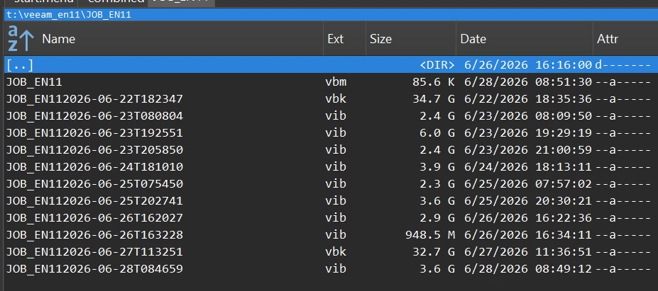

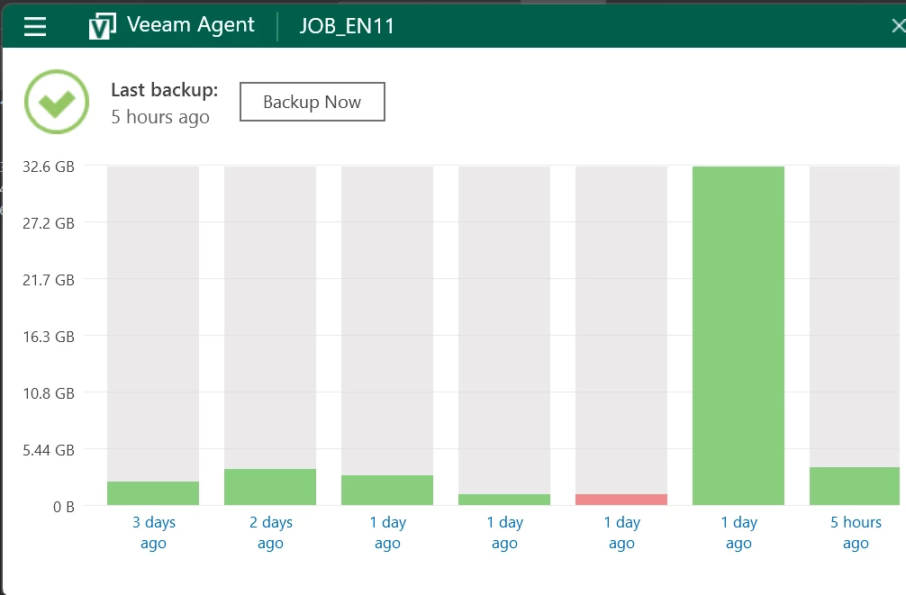

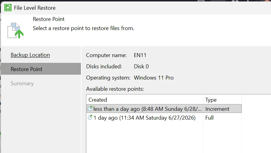

hello, using standalone agent, latest version of 13.0.1220, windows 11 25H2.
my backup job as 11 backups, but when i tried to do a restore, only the latest two backups are listed.
also, the .vbm file lists those two latest backups.
this can be seen three ways as shown in the images below
so, i wanted to know how to re-create the .vbm from a set of .vik|.vbk files ?
i know that VBAR has an import feature but that is not an option for me.
i found these scripts from 2017 that are said not to work anymore
https://forums.veeam.com/viewtopic.php?f=26&t=20568&start=0
any suggestions? thanks, david

Unsure there is a way other than going through support.  It is like the retention rolled up to the latest VBK and VIB file only.  So the VBM does not see the previous chain.  Support is the route to go here as I don't know of a manual way myself.

I didn’t even know there was a scripting way to recreate a .vbm. The only way I knew about was running an Active Full again, and then whatever Veeam Support has to do so. Unless someone else is aware of a way...I’m with Chris here & suggest Support if you’re able to. Keep us posted.
