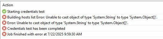

I’m getting a strange problem when I try to configure a protection group to backup my Active Directory.

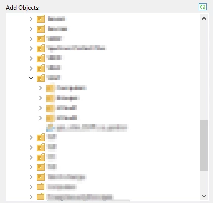

After going through the wizard, then configuring the "Search for object in this domain" and "Selected objects", I can test my credentials within the wizard. When I click on “Test Now”, I'm getting those strange errors:
7/22/2025 9:17:15 AM :: Starting credentials test
(X) 7/22/2025 9:17:15 AM :: Building hosts list Error: Unable to cast object of type 'System.String' to type 'System.Object[]'.
(X) 7/22/2025 9:17:16 AM :: Error: Unable to cast object of type 'System.String' to type 'System.Object[]'.
(X) 7/22/2025 9:17:16 AM :: Job finished with error at 7/22/2025 9:17:16 AM
Screen Capture
I’m a bit confused here, because those errors doesn’t seems to be related to invalid credentials or unable to access the AD (I was able to browse the AD from the wizard).
My Veeam server is in a workgroup, not join into the domain, but I provided my credentials using DOMAIN\username. Is anybody saw this before?

Hi ​@coolsport00,
Thank you very much for your quick answer.
Yes I tried that. Since the Veeam Server is not on the domain, I need to specify DOMAIN\username to logon to my Active Directory server. From the wizard, with those credentials, I’m able to browse all my AD:
So I supposed my credentials works.
When you said local admin account of the machine are you talking about the Veeam Server local admin?
Thank you very much for your help!
Regards,
Yanick

Edit: And strongly recommend this route -- I’m extremely doubtful it’s about Firewall or the username format or anything, error is quite clear:
A string got passed to the underlying code when the underlying code was expecting an Object. Unclear how this happened and it’s probably going to require review of the logs to understand which item is throwing this.
