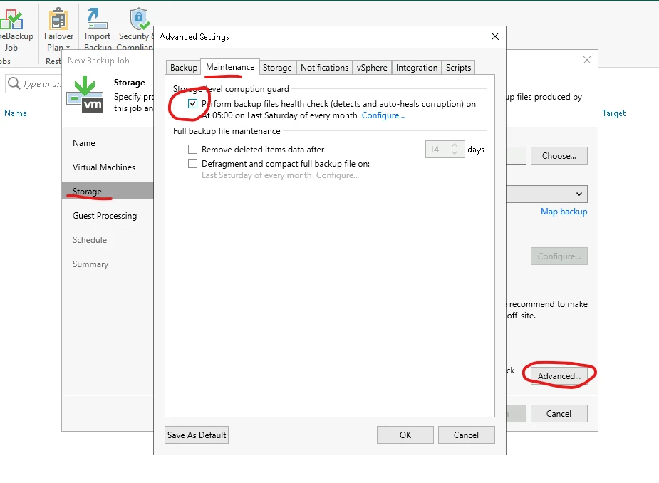

​@bayates826 -
Glad you got your issue sorted. Veeam has a Maintenance tab you can configure your Backup Jobs to auto test your backups for corruption. In your Job settings, go to the Storage section > Advanced button, Maintenance tab and configure the settings there:
https://helpcenter.veeam.com/docs/backup/vsphere/backup_job_advanced_maintenance_vm.html?ver=120
Also, a even more sure-fire way to test your backups is to create SureBackup Jobs and test them out:
https://helpcenter.veeam.com/docs/backup/vsphere/surebackup_hiw.html?ver=120
Best.
AndrePulia
Forum|alt.badge.img+9
  • Veeam Vanguard
  • May 6, 2025 1:14 PM UTC
I was staring my lab, Shane was faster than me :-) here is the screenshot from the maintence tab, mentioned by Shane
