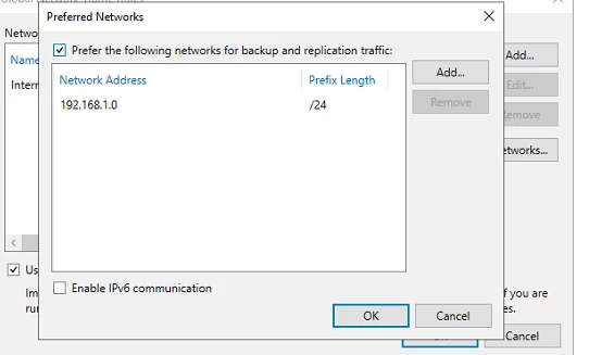

Hi ​@regnor
I have checked the preferred network setting and the 192.168.1.0/24 subnet is there.
Thanks

regnor
Forum|alt.badge.img+14
  • Veeam MVP
  • July 18, 2025
And the 192.168.1.0/24 is directly connected to the VBR Server?
  • Author
  • Not a newbie anymore
  • July 20, 2025
Yes it is...
