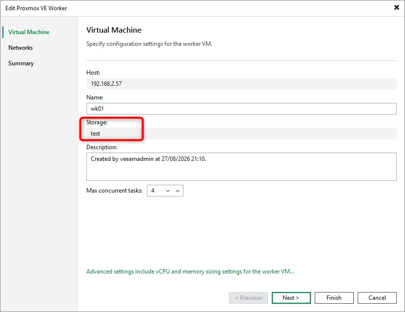

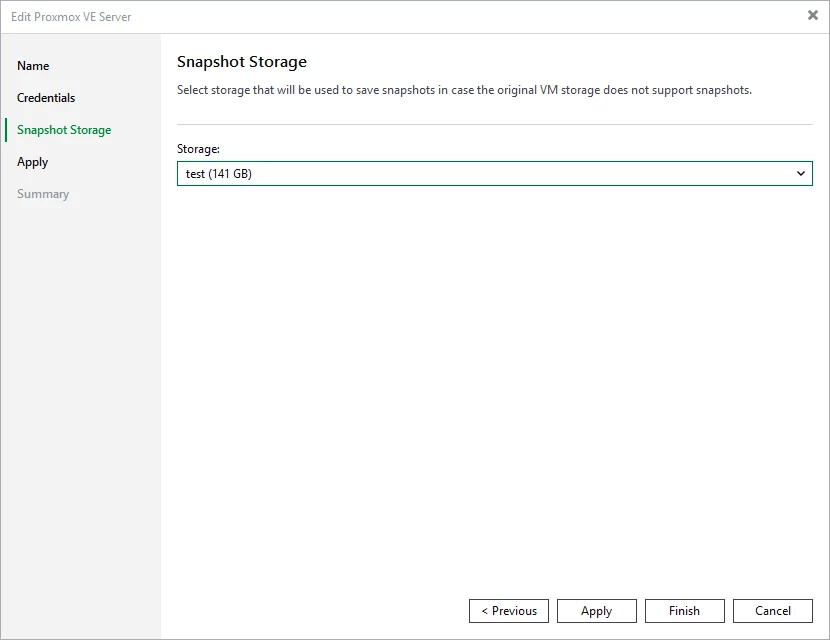

I need some advices for a new setup with VSA and Proxmox.
The setup :
1 cluster with 2 Proxmox node with 1 volume for the OS and 1 volume for the storage of the VM
The storage is done with Datacore Sansymphony (HCI solution).
1 VSA + 2 worker + 1 VIA repository for backup + 1 Synology NAS NFS for backup copy
I read Veeam documentation and limitation and I have 2 mainly questions :
  1. The Snapshot storage must be file level storage. In my scenario, that mean I need to use the volume available on the same disk as the OS right ? Because the storage used for the VM will be block storage …
  1. For the worker, same issue if I understand it correctly, it must be file-level storage that supports snapshots. That mean I also need to use the same volume right ?
How do you usually manage it ?
Finally, for the File system of it, do you use ZFS or XFS or EXT4 ?
Thanks for your answer

The alternate snapshot storage does not have to be on the OS volume. It only needs to be configured in Proxmox as file level storage, and Veeam uses it only when the VM’s original storage cannot snapshot.
EXT4 or XFS is fine underneath a Proxmox directory store. QCOW2 provides the VM snapshot capability. ZFS is block so it won’t satisfy the req.
Worker system disks can reside in the same dir storage, no problem there.
I’d think the Datacore would be the biggest hitch. Veeam lists VMs on custom storage as unsupported. I don’t know much about it other than Datacore calls it a custom storage class.
Hope that helps a little.

damien commenge
Forum|alt.badge.img+7
Hello,
Thanks for your answer.
As you can see on the Proxmox server, I don’t have any other choice than locally…
When I say on OS storage, I mean a directory I add on Proxmox web interface for this need…
How can you see Datacore could not be supported in this scenario ? I’m curious because there is a plugin storage for Datacore on previous versions but maybe this change on V13 ? I’m really curious about it :)
