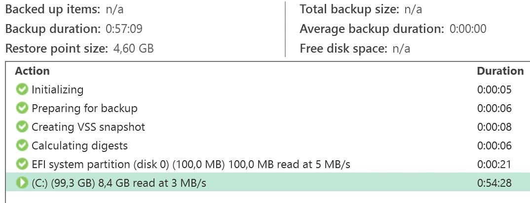

  • May 21, 2025 8:41 PM UTC
i have the same problem to copy to a nas via smb, only with a 3mb/s but in the nas show the in speed network is more a 40mb/s
(C:) (99,3 GB) 8,3 GB read at 3 MB/s
Did you investigate the issue like the OP to see if network related???
