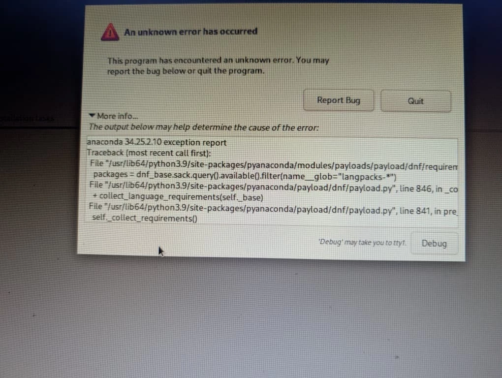

While installing Veeam Backup & Replication v13.0.0.4967 from the ISO (Rocky Linux–based appliance), the installer stops mid-way with an “An unknown error has occurred” message from Anaconda.
The traceback points to dnf/base.py related to remote package selection or repository fetching.
This occurred during the “Downloading packages” stage. Who else has run into this error?

I found the culprit: it had to do with the PVE, and I can attest that the installation was completed successfully. I will discuss this in the blog post.

Kindly ensure that the ISO is correctly copied to Proxmox storage (local, NFS etc as it is in your case). This time, I waited for the upload status to be complete (ok) and it worked eventually. I am not exactly sure what happened in the first upload. Do not forget to verify the checksum for the ISO before upload!

While installing Veeam software appliance. It stuck on download packages. Till 2 hrs didn't get any error. However ticket were logged with Veeam with high priority, but no one responded for 8 hrs. No solution. Two days gone on Veeam iso. And 1 day to install from Iso.
From experience, this issue is usually related to the installation media. Please verify the integrity of the installation media and ensure that any copy operation completes successfully without errors. Also, confirm that the system meets the minimum RAM requirements for the installation.
