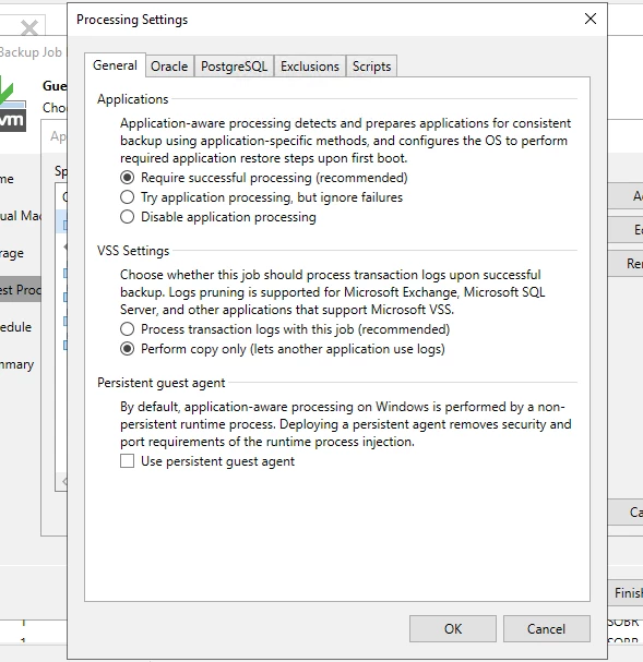

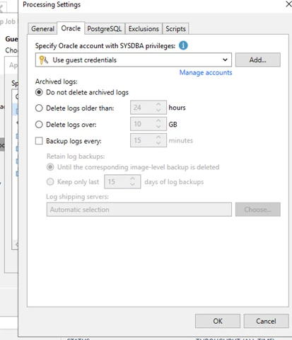

Marcel.K
Forum|alt.badge.img+13
  • Veeam Legend
  • Answer
  • Jun 3, 2025 6:01 AM UTC
i remember such an issue from our customer as well, but it was the processing of logs as well - it was design - because child job (archive logs job) was active so it was actively checking guest
do you use persistent agent?

Marcel.K
  • Veeam Legend
  • Jun 3, 2025 6:51 AM UTC
that’s wired … you don't have enabled even processing of logs …
i would suggest to open case

Marcel.K
  • Veeam Legend
  • Jun 3, 2025 7:32 AM UTC
hmm, but why do you need to backup oracle database via veeam, if logs are handled by 3rd party?
then you can disable application processing and maybe dumps you can backup via VM backup

Marcel.K
  • Veeam Legend
  • Jun 3, 2025 8:57 AM UTC
Dumps are local backups or application like oracle in this case.
If your purpose is indexing, then i would suggest to disable applicating processing, so it should not interfere with oracle like you have.
