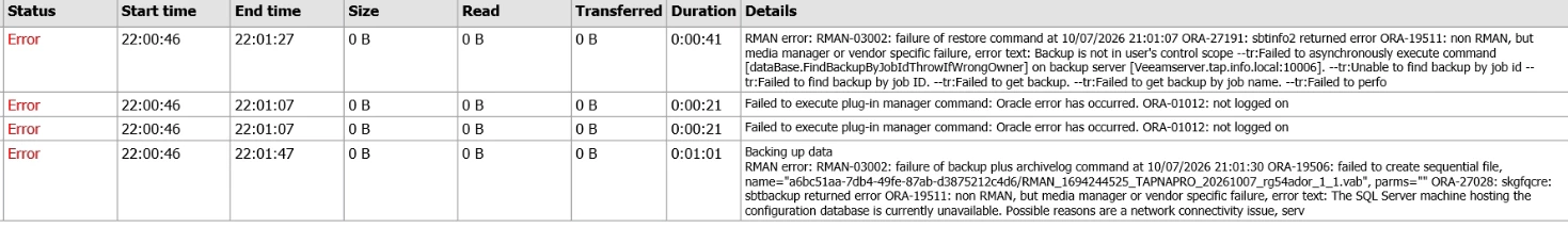

Hi everyone,
I am currently encountering a recurring issue during our Oracle database backups  using the Veeam Plug-in for Oracle RMAN. The backup job fails with the following sequence of errors

We’re on Veeam B&R 12.1.1.56 (Oracle plug-in 12.1.0.2131). I checked the logs in C:\ProgramData\Veeam\Backup, and the main finding is this:
The RMAN errors (ORA-19506 / ORA-27028 / ORA-19511) are only the SBT/Media Manager layer reporting a failure. The “configuration database is currently unavailable” message is misleading, because the VBR logs show the configuration database was reachable the whole time. Other jobs started normally at 22:00, and the Oracle hosts authenticated successfully.
The actual lead is in the plug-in logs:
  • Backup is not in user's control scope
  • dataBase.FindBackupByJobIdThrowIfWrongOwner
  • Unable to find backup by job id
This points to a backup ownership / job ID mismatch in the plug-in workflow. The main job and the separate “Oracle DB Redo Logs Backup” job may also be overlapping, since the log shows “job is already running, starting second time cancelled” right before the failure.
I’m not able to open a support ticket on my side, so if anyone has seen the “WrongOwner” / “not in user’s control scope” error with the Oracle RMAN plug-in, I’d appreciate hearing how you resolved it. Could the job ownership or the Oracle credentials used for the job be the cause?
