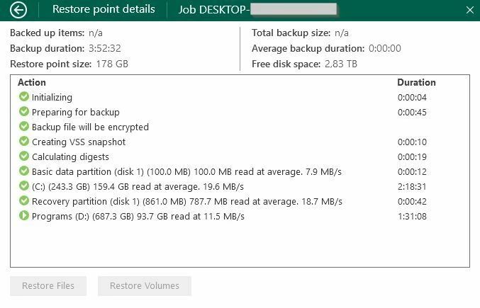

Just today i’ve backed up my PC to external USB3 drive.
I made 2 retrys as i experienced just the same speed problem: from my internal M.2 SSD … Pro drive (2 partitions, one is pretty large) to USB3 transfer rate was only 60-40MB/s, although my PC has no any USB2 port and i know that my previous backup made a couple of month ago worked like a charm. The root of the problem in my case was POOR EXTENDING Male-Female CABLE from my USB3 port (i use for memory sticks, SD cards, ets) connected to USB3 drive’s cable. Just as i removed it and connected USB drive directly to USB port by its own normal USB3 cable the problem has gone away and trasfer speed changed to expected 200-300 MB/s.

For what I see the extremely poor performance problem still present in the latest Veeam Free version for Windows 11…
I have an high end PC and the read speed from C: and D: (both M.2 SSD) is less than 20MB/s.
Unfortunately the software do not even tell you where the bottleneck is located (like it does in the Enterprise version when you backup in other type of environments.
No performance improvement disabling the Antivirus or creating exclusions.

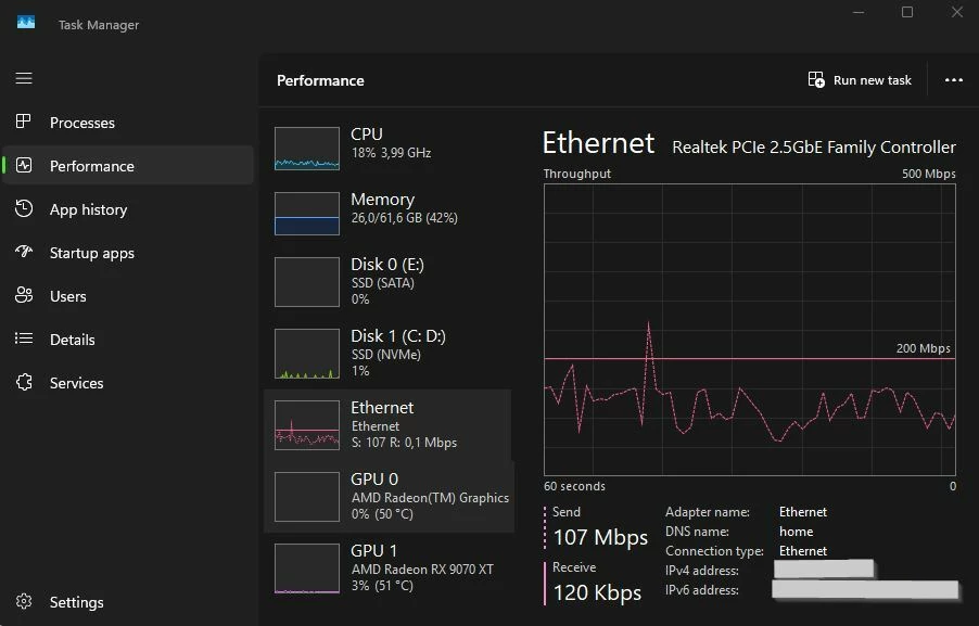

Chris.Childerhose
Forum|alt.badge.img+23
​@Pas what are you targeting for your backups?  I find that plays a part.
