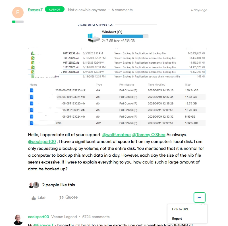

Hello, I appreciate all of your support. ​@wolff.mateus ​@Tommy O'Shea As always, ​@coolsport00 , I have a significant amount of space left on my computer's local disk. I am only requesting a backup by volume, not the entire disk. You mentioned that it is normal for a computer to back up this much data in a day. However, each day the size of the .vib file seems excessive. If I were to explain everything to you, how could such a large amount of data be backed up?

Hi ​@Esayas.T - honestly, it’s hard to say why exactly you get anywhere from 8-18GB of change data per day since I don’t know your environment; and evenso would still be difficult to fully explain. Veeam Agent backups are different than Veeam “image level” (i.e. VM) backups, so honestly..I can’t give a solid answer. As this site is moreso for “general assistance” and not actual Support, I advise you to contact Veeam Support for them to hopefully answer your question. You stated you are using the Free Edition, and with that...Support is really what Veeam calls best effort for your Edition of product. If they have time to answer, they will.

@Esayas.T
I think you’re confusing things a bit by showing multiple backups. As i see it from your screenshots, you’re showing three different backups:
Central_AD
JOB_NIB_FIN
JOB_NFC_IT
Going to guess the first one is your AD server, and this has already been explained, please see the first two posts -- if there are statements which are not clear for you, please ask on those specific statements so we can better advise.
For the other two jobs, the incremental size will depend heavily on the applications / workloads on those servers.
Tell us a bit more about the workloads (applications running on the servers) running on the last two jobs NIB_FIN and NFC_IT -- it may help to explain a bit more why the increments are bigger there.
But again, for the Central_AD job, 1-2 GiB for an increment is normal, this is changed block tracking catching changes to data on the server.
To repeat: Volume level backups work with blocks, not individual files. If a file gets updated even by a single byte, that means one of the blocks changes, and the entire block must be backed up by the increment:
In this example, assume a single volume on a server with 2 files and a database. Full Backup (VBK) has all the blocks.
Blue blocks represent a block in which has changed -- for the file, it could be as simple as someone added a comment, added a few words, changed some text, doesn’t matter. If a single byte on the block is changed, the entire block gets backed up.
Same for the database, maybe you only updated a single column for a row, maybe you added a few new rows, but the underlying block has changed on the storage, and must be backed up.
See why it matters a bit? More information is needed on what is actually running on these servers -- do not think about it as “what file changed?” just think about the activity. An Active Directory server will be constantly doing maintenance, logging data, etc. An SQL server will be very busy as well and produce a lot of changes.
I would ignore the Central_AD backup, that really looks very normal.
For your other server, more details needed.

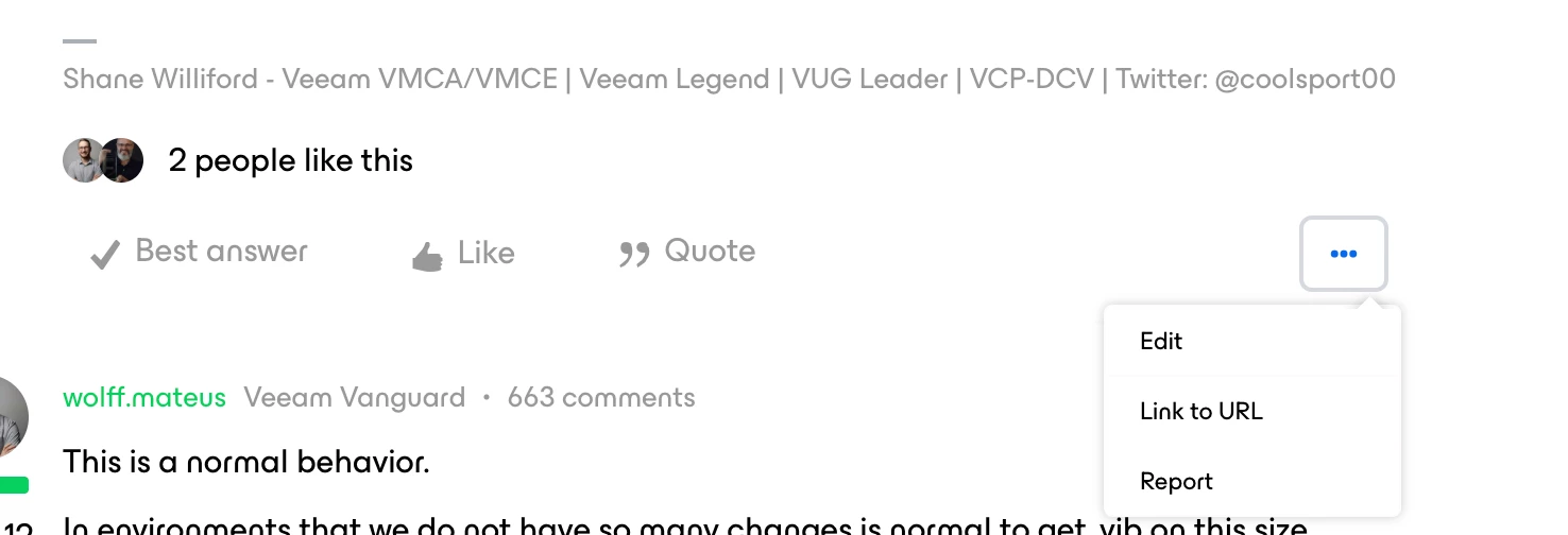

Hi ​@Esayas.T - try the below. If you still have issues, let me know via DM.

I do not see three ellipses under my post; it only displays a link to the URL and a report option. How can I access that?

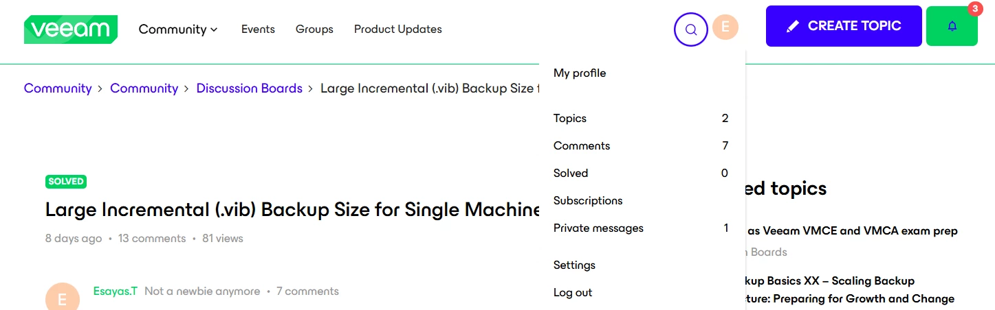

Ok, thank you ​@Esayas.T . Let me also ask...are you logged into the Community Hub site (check in the upper right of the Community Hub site and make sure your logged in)? If not, you do need to log in to modify your post or comments. If you are...I’ll ping ​@safiya ….

Yes ​@coolsport00  i did log in to the community hub.
