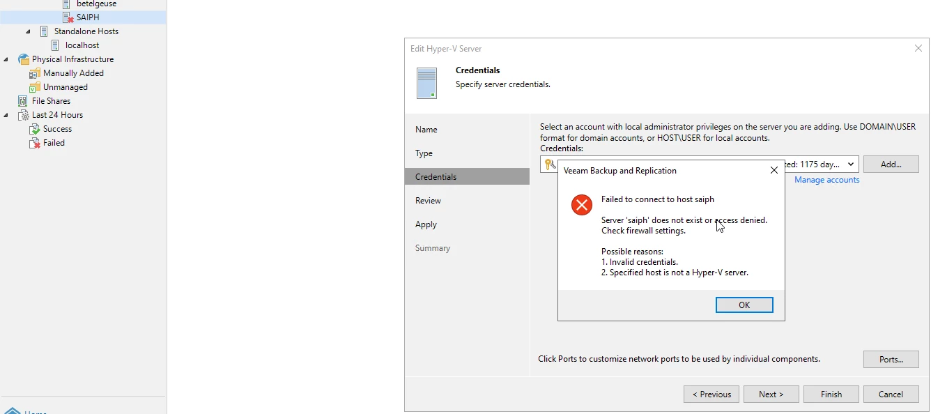

Yes, we tried the Edit Hyper-V Server wizard. This is actually where we found the connection problem.
When we proceed with the existing SAIPH entry, the wizard fails at the Credentials step with:
“Failed to connect to host saiph”
“Server ‘saiph’ does not exist or access denied.”
We also verified that the credentials themselves are valid, without exposing any credentials or domain details:
  • We used the same account configured in Veeam.
  • On SAIPH, we authenticated with that account using runas.
  • The password was accepted and a new CMD session was opened under that account.
  • whoami confirmed the expected administrator account.
So the credentials appear to be valid, but Veeam still cannot establish the Hyper-V connection to SAIPH through the wizard.
We have attached a screenshot of the Veeam wizard showing the failure.
Thanks again for pointing us in this direction. Any further thoughts on what could prevent the Hyper-V connection/registration despite valid credentials would be greatly appreciated.
