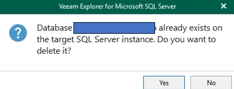

Our DBA are trying to restore a DB to a new server. The DB is huge and the restore process takes several hours. Within those hours, there are new transactions coming in and being backed up using transaction logging. How can we add or restore those new transactions on top of the previously restored DB without doing another full restore using Veeam SQL Explorer? I tried several options but I always end up with the message below.

We are doing transaction log backups. So wondering how can we add these new transactions on top of the previous restore to the new DB server. I can move the slider bar to approximately to the latest transaction log backup but once done, it gives the message it will delete the existing DB which we do not want since the restore will take hours again.

You do not have option to restore only the transaction log. The transaction works together with entire DB. If you opt to restore a database, you always will restore the entire database.

This is exactly what happens.  This is why you may want to restore to new location/DB so you don't replace the existing one.
