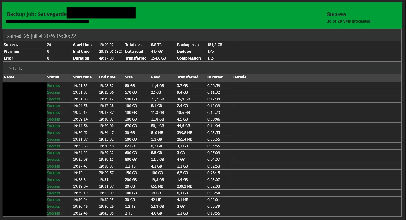

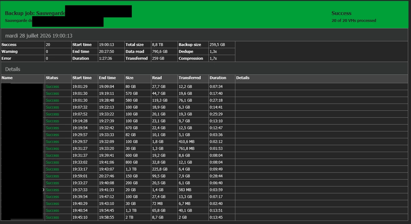

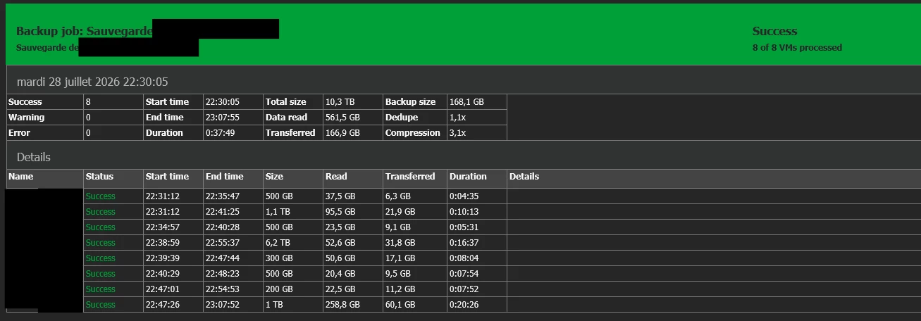

Normal incremental backup reports
Job 1:
Job 2:

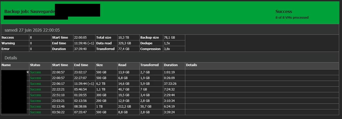

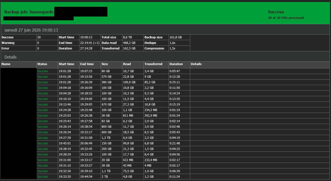

Normal Synthetic Full reports
Job 1:
Job 2:

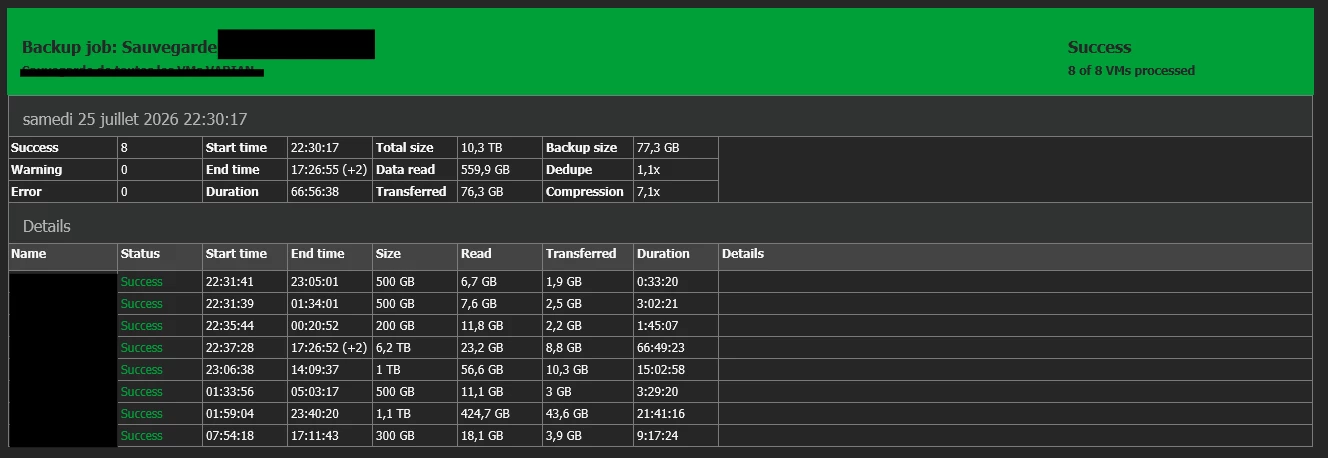

Synthetic Full report from this weekend
This week's Synthetic Full took even longer because the previous weekend's Synthetic Full could not complete. Even taking that into account, I still find the execution time excessive.
Job 1:
Job 2:
