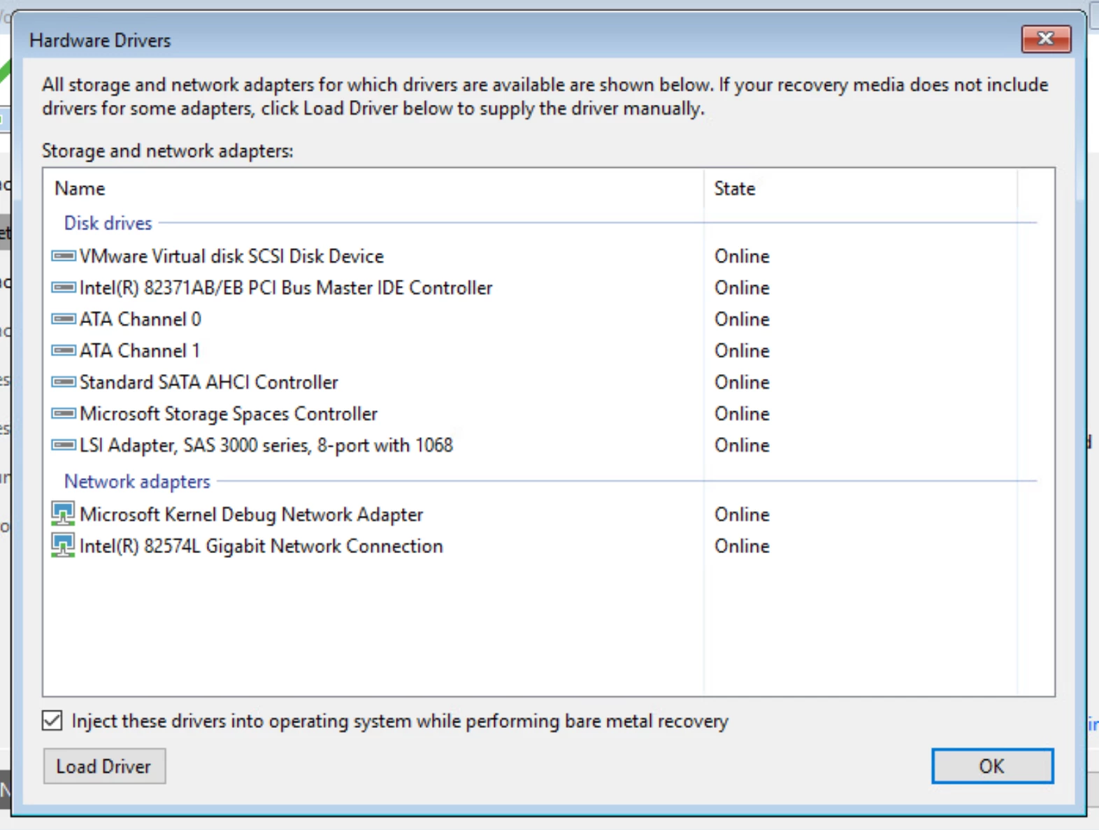

The physical server does use RAID and saw the “Base System Device” as an “unknown device”. Could this be the culprit?
If so, I wonder how I would even go about getting a driver for that. Not sure what kind of device that is.

These are the list of devices that have been detected..
