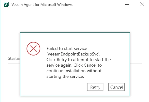

Hi
i have a PC that was being backed up wit veeam agent for windows free edition not managed by VBR
The PC is runing windows 10 22H2 ,
After an agent update started getting the error failed to start service "VeeamEndpointBackupSvc"
Tried repairing the agent , i tried removing it and reinstalling it still getting the same error .
It seems something with the agent setting is wrong and removing the agent doesn't really clean all the data from the PC , tried even installing older version still the same.
Also i am not seeing that service registered in services
Any ideas how to purge the data ?  Or Fix this issue ?
Thanks

Well that did not help :(
I have performed unistall,
Deleted files from c:\Program Files
Deleted files from %programdata%
performed search for files in local and roaming profile none found
performed deletion of all veeam settings in registry
performed restart
reinstalled and still the same issue
Failed to start service
‘VeeamEndpointBackupSvc'.
Click Retry to attempt to start the
service again. Click Cancel to
continue installation without
starting the service.
according to log the service was registered but i dont see it in the service list
Very weird :/

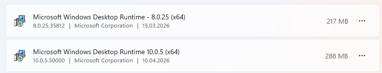

I try to install VeeamAgentWindows_13.0.2.1102.exe on Win11 25H2 Build 26200.8117 and always get
Since upgrade from a version 1 year ago failed on this, too, I completely removed old version, several restarts and tried new install but the error remains.
I checked and reinstalled:
Shouldn’t both 8.0.25 be correct?

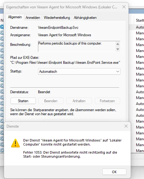

When I try to manually start the service it fails:
