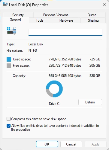

C:\ is at 205 GB free, 725 GB used, of 930 GB total (~22% free, ~78% used)

Based on the size of your disk and the working room needed for VSS I am not sure 205GB free will suffice.  You can specify where VSS saves snapshots and can move it off C drive.  Might be something to try.

I freed up a significant amount of space:
However, backup attempts still fail with the same error. If more space is required, could I specify my SMB share as the location to use for VSS snapshots? Looking at the article that ​@CMF linked, I don’t see anything about using a non-local disk. I suspect replacing

You still need the used space plus working room.  Need to investigate VSS more and settings, etc.
