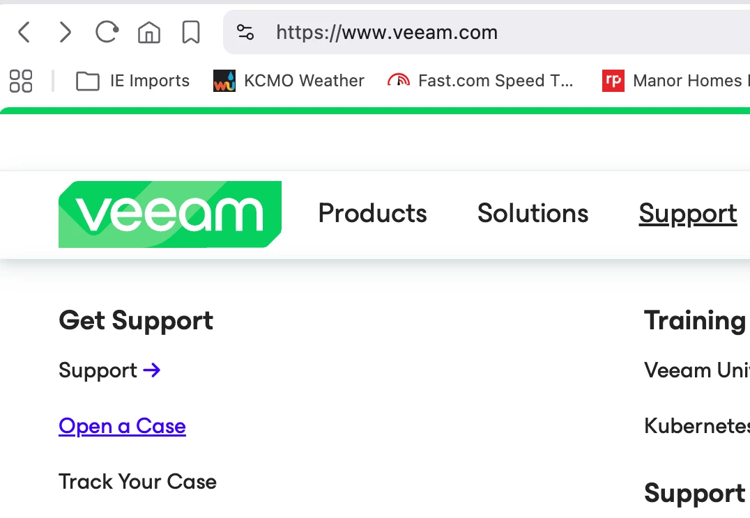

Go to veeam.com, hover your mouse on the Support tab, then click open a case:
You are then directed to login and proceed to open a case.
