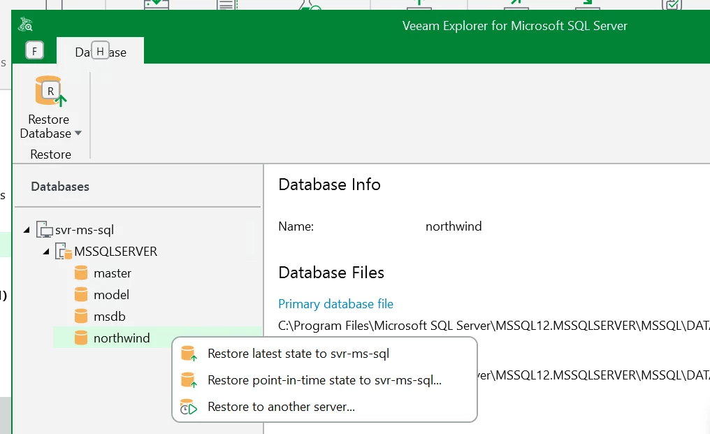

Recently, I configured Veeam Backup & Restore version 13 to back up my Windows SQL Server. The database backup completed successfully, but when I attempted to restore it on a per‑table basis, I noticed that this cannot be done via the plug‑ins. The interface looks like this:
Restore interface for MSSQL Server using Plug‑Ins

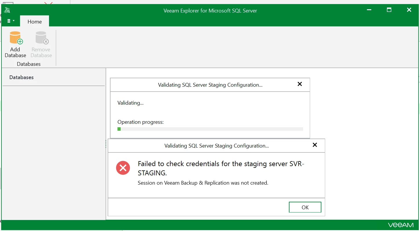

After that, I checked the Veeam guide and noticed that if I want to perform a per‑table restore, I first need to configure a staging server in Veeam Explorer for MSSQL. However, when I try to add the staging server, I encounter the following error messages:
Staging Server cant be added to Controller

Is the staging server the same or newer SQL server that you are trying to restore?
Check here - https://helpcenter.veeam.com/docs/vbr/userguide/vesql_configure_staging.html?ver=13

Also, make sure your SQL Staging Server is *not* part of a Failover Cluster. If you meet the requirements in the link Chris shared, it’s best you open a Veeam Support case.
