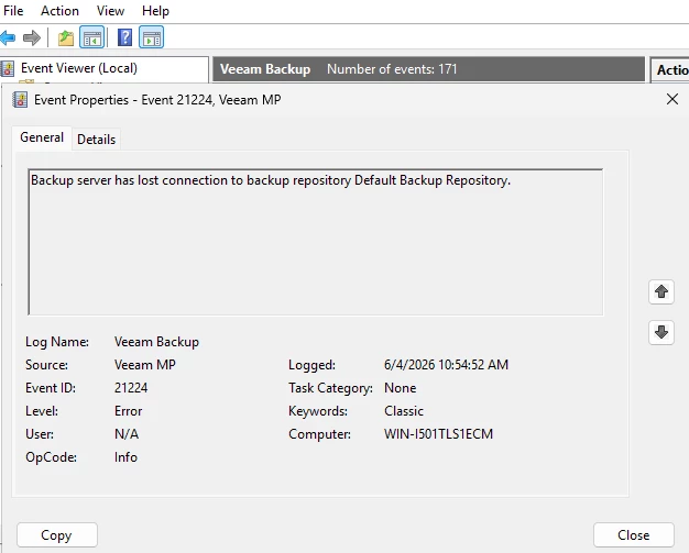

This from the Event Viewer

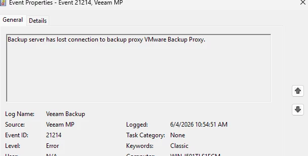

  • Jun 4, 2026 8:54 PM UTC

​@AVeeam Novice - you may have a port conflict with something on your VBR server due services Veeam uses. See this for Port requirements:
https://helpcenter.veeam.com/docs/vbr/userguide/used_ports.html
Also, if you have A/V make sure to add exclusions as noted in Veeam KB1999
https://veeam.com/KB1999
Otherwise, yes... Support Case is your best option.
