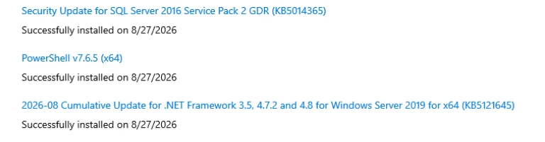

I am not entirely sure, but I can say I am on v13.1.0411 and have not committed an update since install early August. I did however apply some Windows updates on this box.
I do have an alarm in VOne that says I am having issues with “Veeam B&R server data Collection delay” which is odd and only appeared after the updates and is alongside the service issues described by OP.
