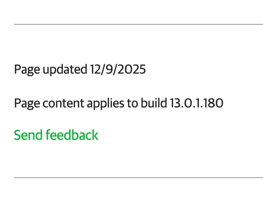

Maybe I am going blind, where is the feedback located?
coolsport00
Forum|alt.badge.img+21
  • Veeam Legend
  • December 15, 2025
At the bottom of the various pages of the User Guide:
User Guide Send Feedback
