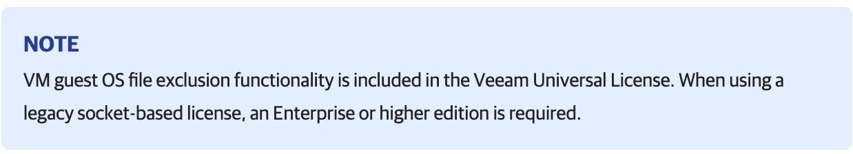

It seems the FILE EXCLUSION tab is missing in Veeam Community edition even though the only thing it is supposed to be limited don is the number of workloads. When I go to the job, guest processing and edit, there is no choice to exclude files. What am I missing here?

I believe they removed that in the CE edition for v13.  I think you need paid edition now but I would check with sales to be sure.

Hi ​@vvmicro -
Chris is correct. See the User Guide:
https://helpcenter.veeam.com/docs/vbr/userguide/backup_job_vss_exclude.html?ver=13
Specifically, see the note/bullet in the link above:
File Exclusion Requirement
Make sure to see the limitations associated with File Exclusions as well:
https://helpcenter.veeam.com/docs/vbr/userguide/guest_file_exclusion.html?ver=13#reqs
Hope that helps.

Even though the only thing it is supposed to be limited don is the number of workloads.
From our „free licenses“, the NFR licence has no limitations while the community edition does. You can find the full list for each edition (community edition and paid) in our comparison guide:
https://www.veeam.com/veeam_data_platform_feature_comparison_ds.pdf

Yes this helps, but they need to update the info the Community Edition then, it still states it is a fully functioning copy and only limited in the number of workloads it can handle. Maybe I will revert back to v12 for the time being. Thank you!
