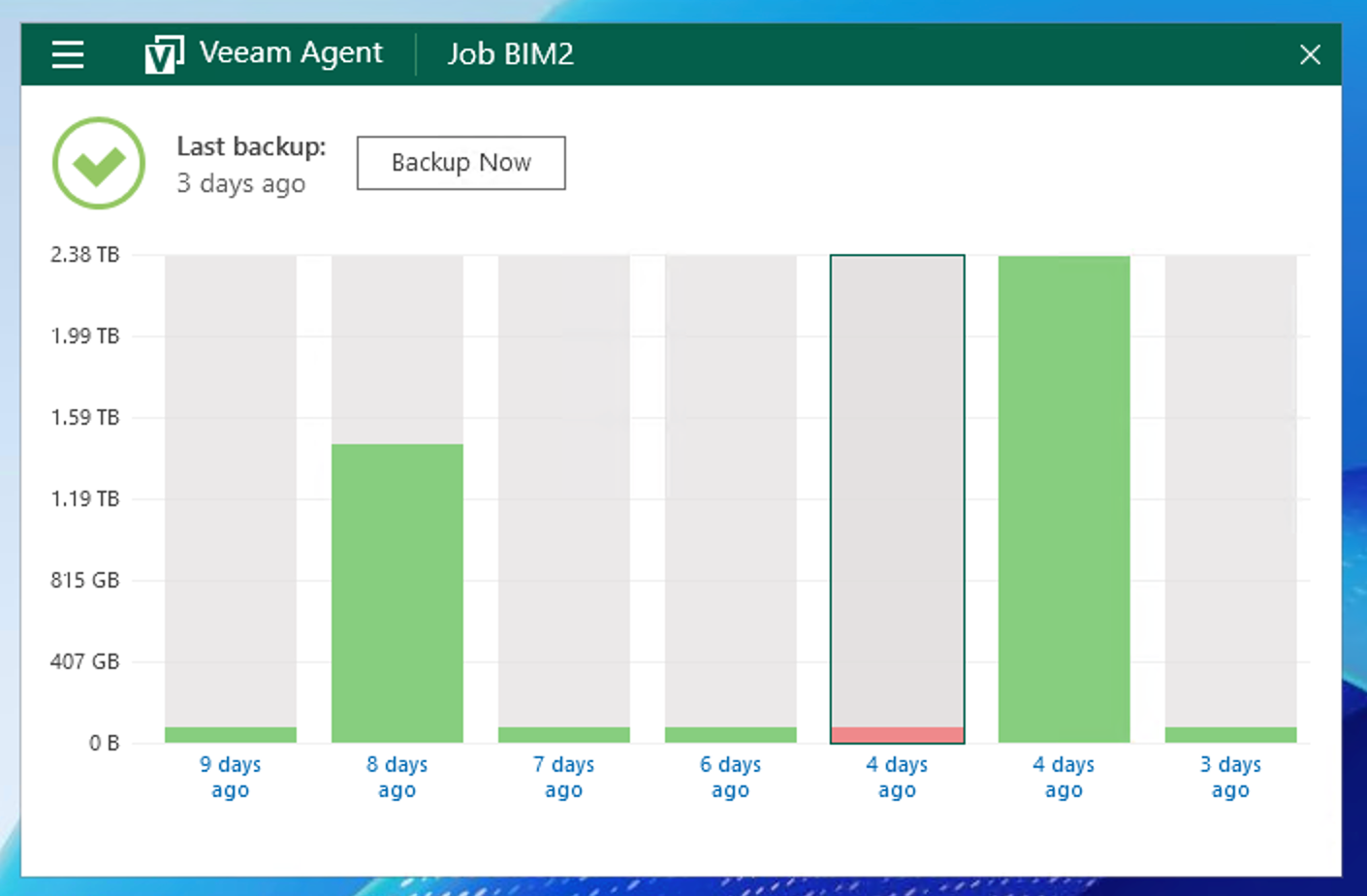

Since WindowsServerBackup does not support backups of drives over 16TB, I thought I give Veeam Backup Agent for Windows.
Unfortunately it only works for some days and then fails. But let’s start from the beginning.
  • Host is Windows Server 2025
  • Bare metal
  • File level backup to an external 3.5” HDD
  • set to run daily
Now, let’s look at what happened:
  • 9 days ago we created the job.
  • This worked well until 5 days ago
  • For some reasons, nothing happened 5 days ago

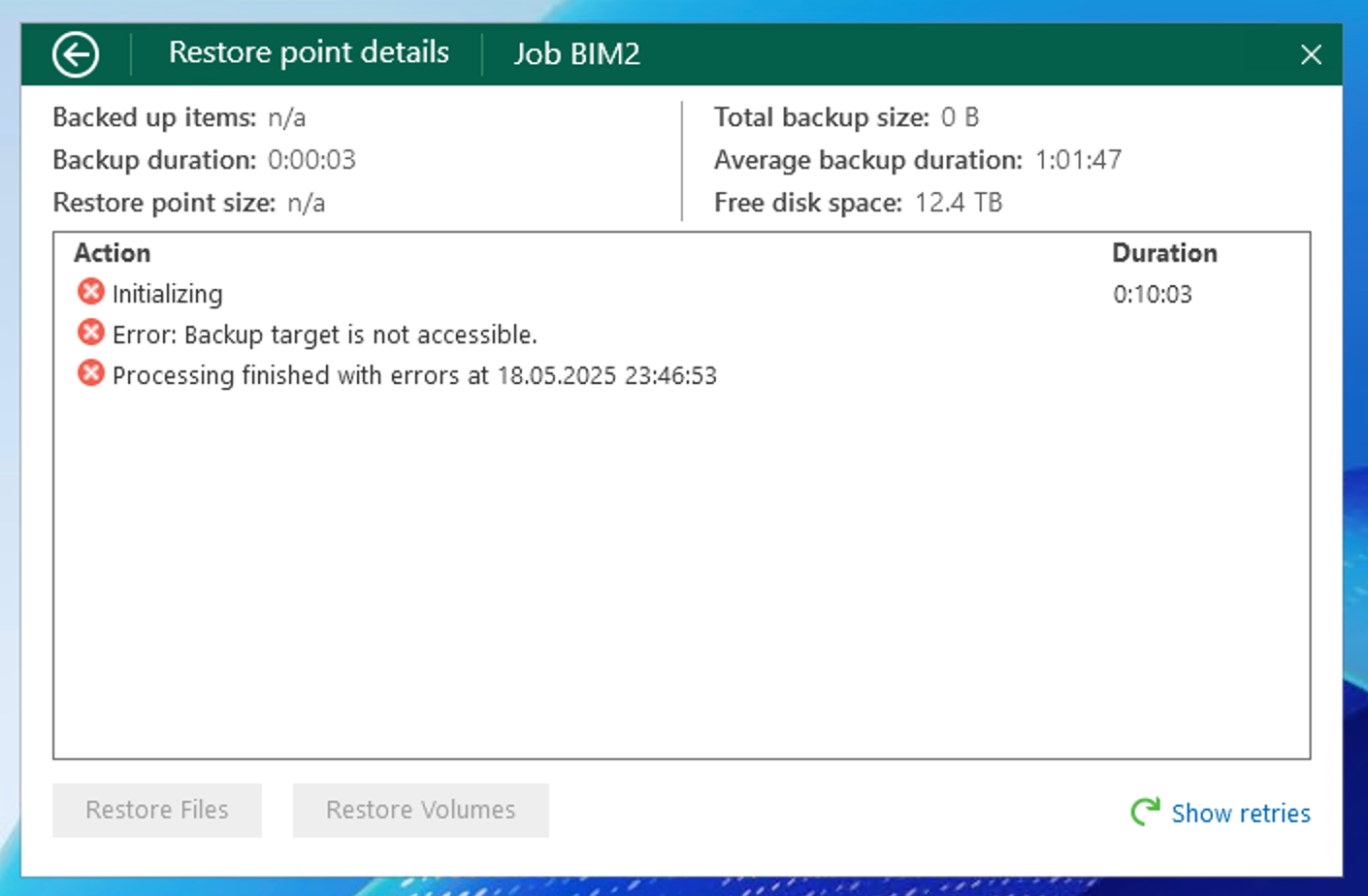

  • 4 days ago, I got this error:
  • this is rather starnge, since I was able to look at the drive E: that hosts the disk.
  • I clicked manually to run another backup. This worked and created the succesful backup 4 days ago
  • 3 days ago it also worked
  • 2 and 1 day ago, again nothing happened.

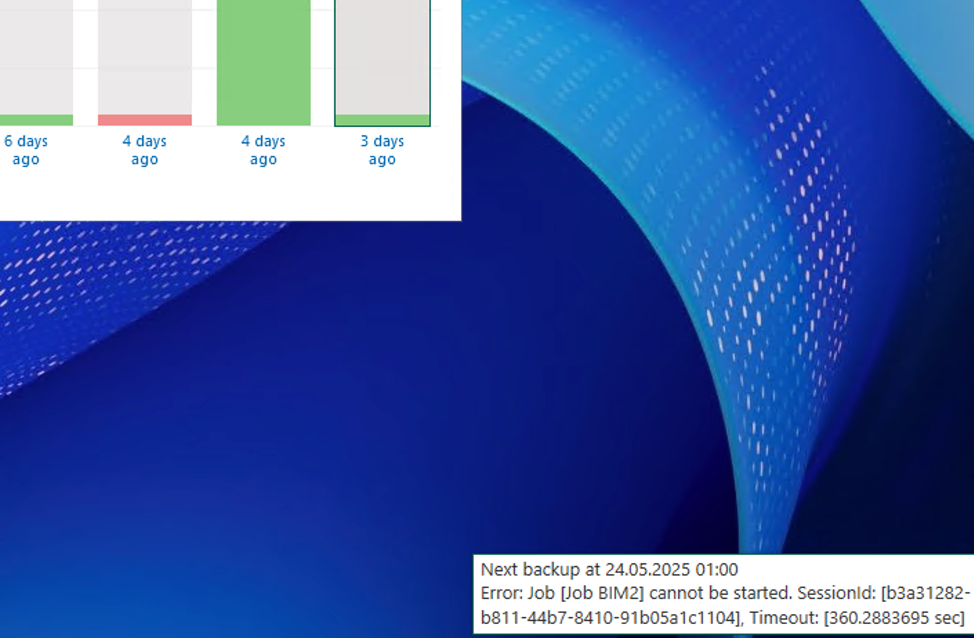

when I hover over Veeam, I see this error:
any ideas what is happening here?

I assume you’re using Veeam Agent for Windows?..and Free Edition? Look at the log location in:
C:\ProgramData\Veeam\Backup\Endpoint\<job-name> to see if there is anything in it with better info to troubleshoot.
https://www.veeam.com/kb2404
I couldn’t find much in my search on your error. At the very least, you could open a Support Case with Veeam to see what they say (as a ‘best effort’ kinda thing):
https://helpcenter.veeam.com/docs/agentforwindows/userguide/support_report.html?ver=60

Maybe the external disk has an energy saving mode or stuff like that. The error basically says that the target is not available so you should check and disable any kind of power saving settings.

​@MariaMiller Error message looks relevant to this and please check this KB https://www.veeam.com/kb1909

​@lukas.k it is basically just external Seagate drive without any configurable settings. I changed it from “Quick removal” to “Better performance” without any luck.
