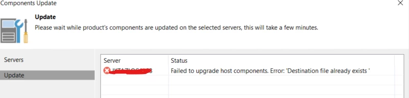

I upgrade my VBR then when try to upgrade the component for my hyper-v i got error the destination file already exists.
How we can solve this?

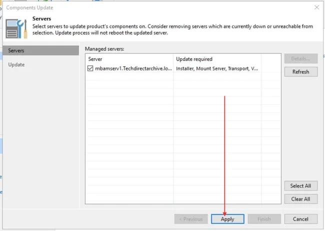

During the VBR upgrade, did you select “Update remote components automatically”? Your image shared shows this must have been selected due to the information on it as discussed here and here.
When not selected, you would have a similar windows as below: See for more information: How to upgrade Veeam Backup and Replication v11 to 12.1 - TechDirectArchive

Agree with Christian here ​@hs08 . It appears your components are upgraded already it looks like.

the problem was solved by removing the installer on targer server then do update again from VBR. Thanks ​@coolsport00 ​@Iams3le

Ah yes...have seen that before. Thank you for sharing what worked for you ​@hs08
