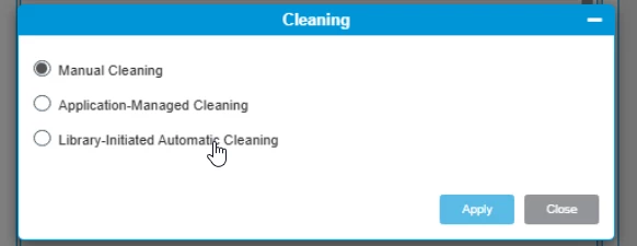

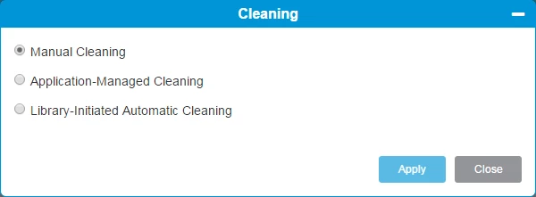

I prefer to configure cleaning slot in the library and configure a policie. Cleaning slots are system assigned, reserved storage slots to store LTO cleaning media for library-initiated, automatic drive cleaning operations (configurable as a partition cleaning policy on a per partition basis), or user-initiated, manual drive cleaning operations.
Configure a policie for partition Cleaning
Manual Cleaning (Default): Allows you to manually initiate cleaning. You will receive a RAS ticket notification that cleaning is needed.
Application-Managed Cleaning: Allows you to let a third party application determine when drives need to be cleaned.
Library-Initiated Automatic Cleaning: Allows you to set up the library to communicate with drives to determine when they need to be cleaned and automatically clean the drive. You must have cleaning slots defined to use this feature.

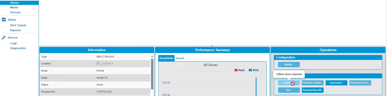

I also just noticed that I’m not even able to initiate the tape cleaning process manually from the Scalar web interface — or maybe I’m in the wrong menu/view.

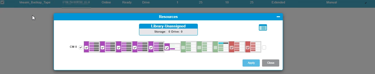

Is the Scalar unit partitioned or are all the slots in one partition presented to Veeam?  That is where you need to look first.  Unsure about the cleaning option in the menus as I don’t use Scalar at all.

​@itsadmin you must first switch your drive offline for a manual cleaning.
could you please provide a capture of your partitions ?

You can try application-managed cleaning but I would select the library automatic one instead.

I've tried all three options, including application-managed, but I still can't get it to work.

Little lost from the thread but ​@itsadmin, can you confirm you configured a specific cleaning slot as opposed to inserting the cleaning tape into an empty slot on the partition accessible by Veeam? Is that correct?
yes thats right. You cann se this here in the blue slot

I'm surprised that I can't initiate a cleaning through the Scalar either.
