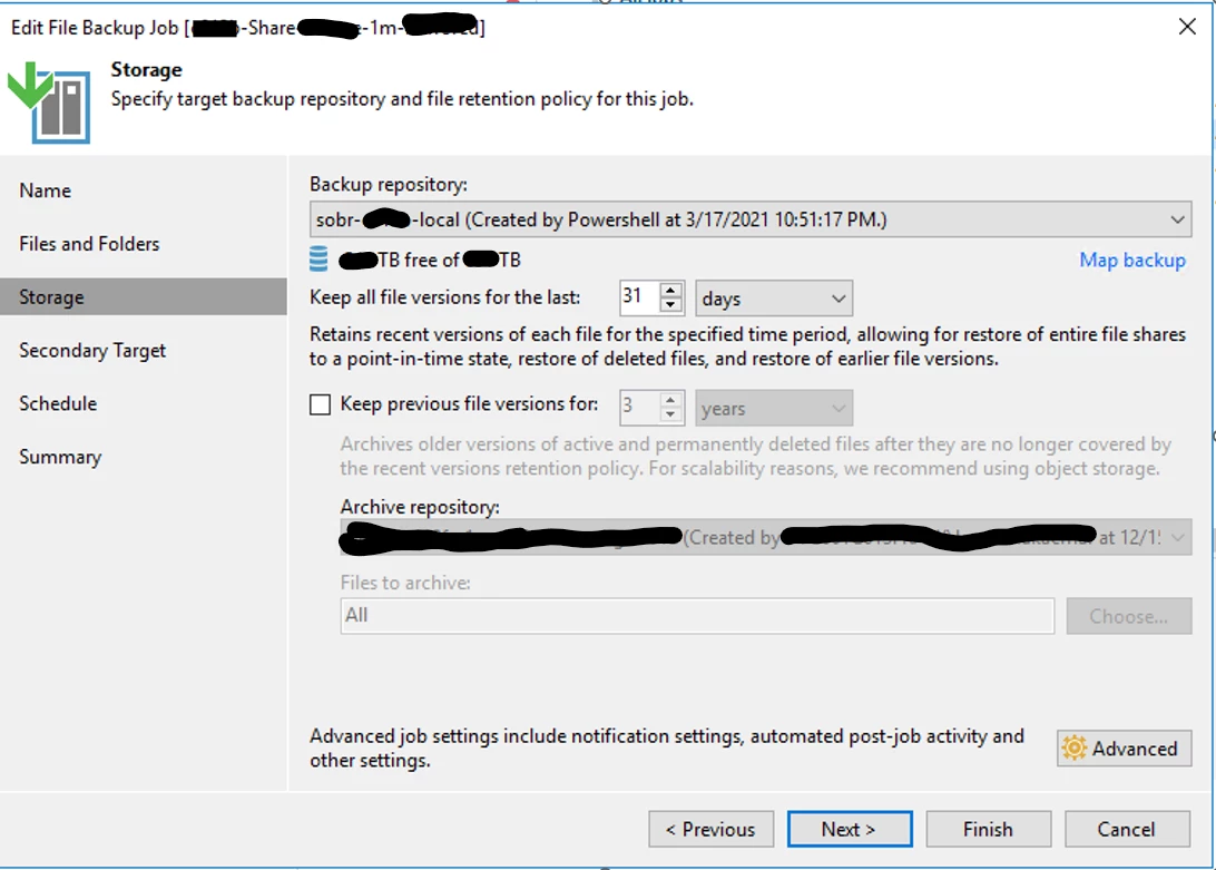

yes, is possible, see my screenshot, that repository is sobr not single repository

for me is working, but i have used virtual Ontap as NAS filer and sobr is not datadomain, but linux hardened repositories (4 extents), maybe if i will have option to test DD, then will not working …
Since Console wizard is not blocking such configuration and no additional tricks like regkey, …., i think is not unsupported way ...

As per the supported repositories list:
Unstructured Data Backups can go to a Scale-Out Backup Repository, the limitation is that these backups will not offload to a configured capacity tier.
In addition, Unstructured Data Backups cannot target a Scale-Out Backup Repository with a performance tier made up of object repository extents.

Thanks for all the provided informations ,it was helpfull , thank you all , and thanks to Marcel , i tried your solution and it worked for me.
