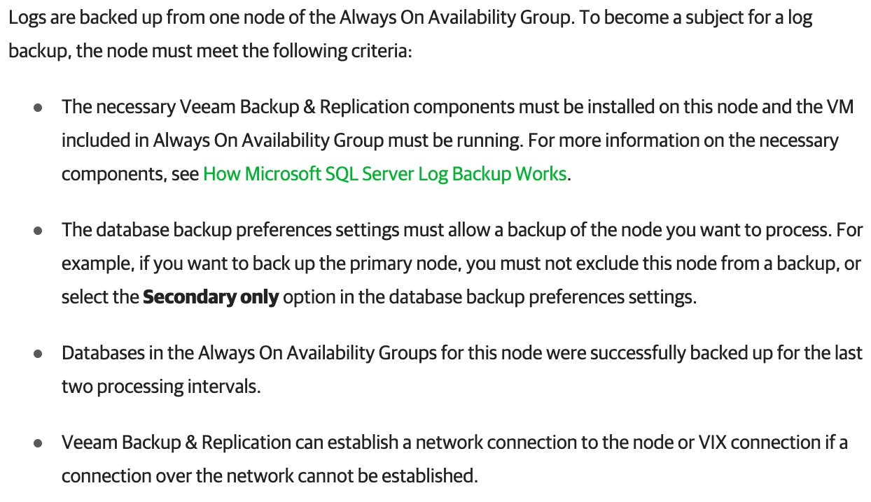

Hi ​@jrivera -
This section of the User Guide discusses SQL AO specifically, and discusses about Transaction Logs:
https://helpcenter.veeam.com/docs/backup/vsphere/alwayson_support.html?ver=120
Pay attention to the section of the requirements you need to meet for the Logs to be backed up. Logs are backed up from only 1 node, and that node must meet the following criteria:
Hope that helps.
