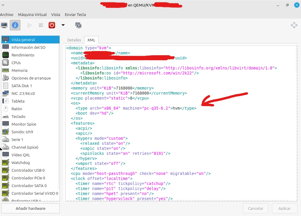

Hello, from my point of view you need to enable UEFI systém with secure boot
I have this error if machine=“pc-q35-8.2”
machine=“pc-q35-6.2” works well

Marcel.K
Forum|alt.badge.img+13
  • Veeam Legend
  • January 5, 2026
There are several reasons:
1) duplicated or zero-ed UUID
You can check via power stella like
Get-WmiObject Win32_ComputerSystemProduct | Select-Object UUID
2) compatibility issue - try to change chipset to q35-8.0
3) if you changed booting from bios to UEFA, then identificators could by not valím anymore
