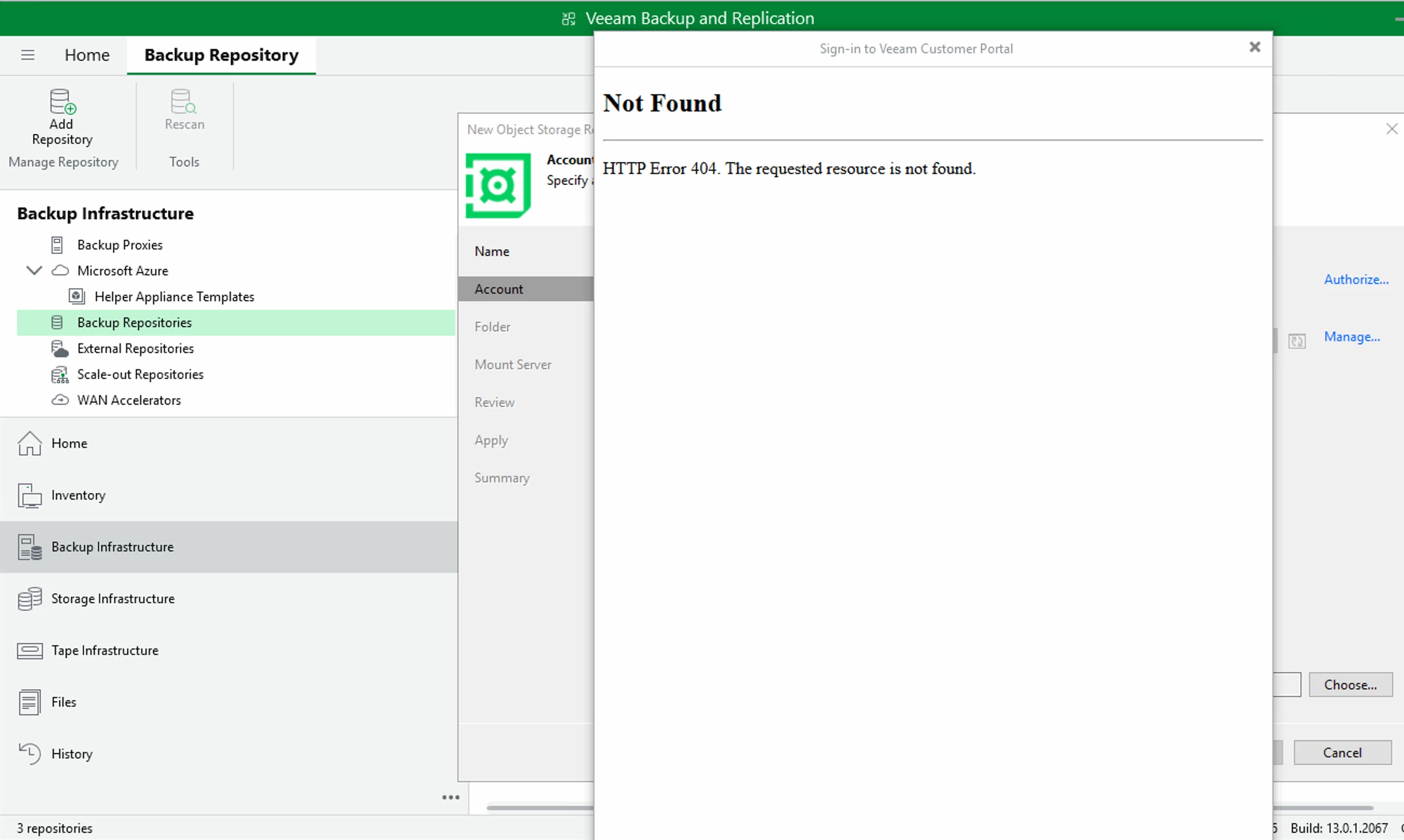

Hi,
we have Veeam Backup and Replication v13, Community Edition, Build 2067 on Microsoft Windows Server 2019 with Hyper-V.
When I try to add a Veeam Data Cloud Vault from the Austria East Region I get the following error:
The error occurs during authorization of the backup server after I login using Microsoft, including MFA and after I answer the question if I want to stay signed in (Yes or No has the same effect).
If I add the same VDCV Repo on another installation of Veeam (different customer, paid version) it works.
I installed the Veeam Console on the only VM of the server and I got the same error.
AI suggested to check the version of a specific DLL, which is 2067.
I installed a trial license, same error.
I disabled all security filtering on the firewall temporarily and checked the logs.
Any ideas, how this can be fixed?

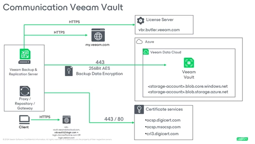

Hi ​@Thomas Lahl ,
to add succesfully VDC Vault you need to have internet connections. If you use a firewall please check your VBR can contact these URLs:

By any chance were using doing this from a remote console? Eg not running it locally on the vbr server itself?

Good morning to all of you,
The Case is # 08095122.
Thanks for all the thoughts and replies.
I am glad that the official Veeam Docs are right and VDCV is supported in the CE.
The installation is on the Hyper-V host itself.
I tried with the console on the Hyper-V host, and I installed the console on the only VM on the host.
Both methods brought the same results.
