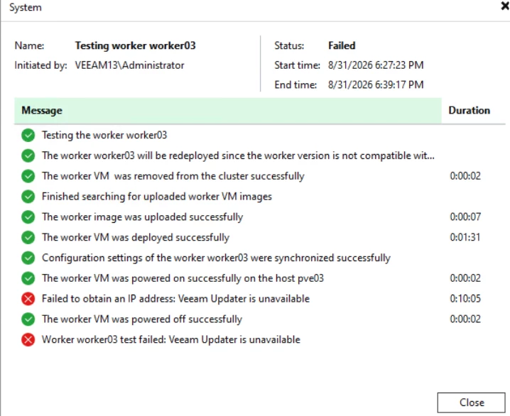

Hi Everyone,
I installed Veeam 13.1 on Windows Server 2022 without joining an AD domain and in an environment without internet access. I used IP addresses when adding the PVE9.2, but when I deployed the workers, the installation failed with the error “Veeam Updater is unavailable.” Later, I set up DNS forward and reverse lookups for the PVE and worker IPs, but the same error persisted. I unchecked the “Check for updates online” option for the workers.
Does Veeam require an internet connection for the worker to install packages?
Translated with DeepL.com (free version)

Hi ​@nsofl.chen! During the V13.1 beta the update servers weren’t available but the worker deployment proceeded after the update ran into a time out. I just tried it again in my lab with the latest build and the deployment succeeded. Could you post a screenshot of your error message or share the full message?

Hi ​@regnor
This error occurs in version 13.1. I reinstalled version 13.0, and it worked fine, but after I updated to 13.1.0.411 or 118, the error reappeared.
regnor
Forum|alt.badge.img+14
  • Veeam MVP
  • September 1, 2026
This looks like a different issue than the Veeam Update Repositories not being reachable. Is there a firewall or proxy between the workers and the Veeam Backup & Replication Server?
