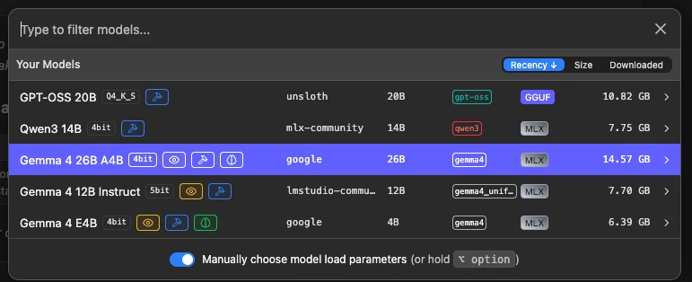

Nice post Zane. I am running LM studio on a Mac Mini, alas 24GB since it was purchased for me recently and prices well… :(
I also have VLLM running in a 3 node Talos cluster which I can try but that is on VM with no GPU so..
One question I think Ollama supports MLX like LM_Studio are you using an MLX optimized model? I found a big difference since it is the native Apple Framework.
Will give this attack a test drive as well :) On my weaker system Gemma 4 26B A4B MLX is the best but with 32GB you can do better.

I thought it best to go check rather than try an answer from memory, so I did.
 Ollama side, I believe MLX isn't really opt-in anymore. It moved to MLX on Apple Silicon in 0.19 back in March and made it the default engine in 0.30 in May. I'm on 0.32.5, and running MLX the whole time without my choosing it. LM Studio got there earlier.
What I found when I actually measured: qwen2.5 14B, about 9GB of weights, 11.15 tokens/sec generation on a base M4 mini with 32GB. So, roughly 100 GB/s of memory bandwidth on a chip that tops out near 120. so theoretically 84%. Constraint is memory bandwidth, and not the  engine. And don’t think I can tune the  framework. Smaller quantized weights would help, but only in proportion to the file size.
You're right that the framework matters, and I'd have been leaving real performance on the table on an older build. In my case the ceiling turned out to be the hardware.
THank you for the reply. Now, I'm setting up proper benchmarking  and would rather borrow a methodology than invent one.
