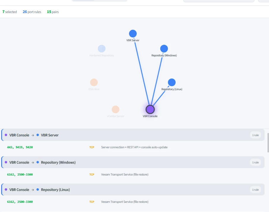

Very neat feature, but a question comes up while testing a few scenarios:
  1. Why does remote console need connection to non-hardened repositories, but not the hardened one here?
  2. The ports tell about “file restore”, but I’m not sure on the source of this, as I don't see this in the ports list (Note: I’m aware this list is suspect, we’re working on it but point is more what is the source that we need Remote Console => repo connections for file restore?)
    1. If you're talking about mounting to console, I can understand but doesn’t hardened repository need this also?

Hey David, good catch!
those ports are listed under “common ports” here: https://helpcenter.veeam.com/docs/vbr/userguide/used_ports.html?ver=13#common-ports
and you are correct, it should exist for the hardened repo as well. This was missed as the hardened repo was added later on in the process, and apparently didn’t inherit the rule.  It will be added to the list!

Great, thanks for the answer ​@tsmith
I would add in an additional request then, can we mark 2500-3300 as “optional failover” somehow in this tool? To best of my knowledge, most all places where 2500-3300 used to be required it is now optional as a failback, everything should go through 6162 now I suppose
