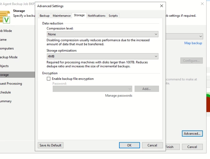

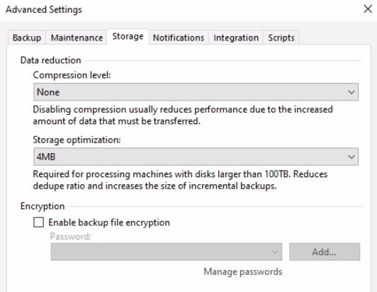

Matheus, I don’t know if you change some default settings like compression an storage optimization.
For image and audio files, is good to disable the compression level, but for transfering on WAN link is good to have a higher compression level. I wld suggest you to do some tests using compression disabled and higher levels, the amount of compute resource is very related to I/O profile.
DO some adjustes on the storage optimization as well.
matheusgiovanini
Forum|alt.badge.img+12
Thank you for the suggestions, Andre!
I already set the compression level to none. That environment is really a headache 😓
