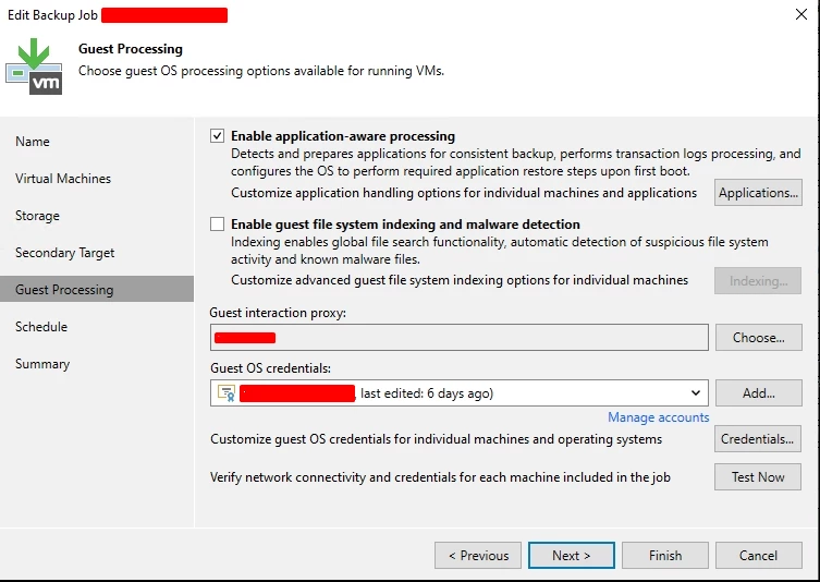

Configuring Application-Aware Processing
The first step was to enable Application-Aware Processing in the VM backup job.
The guest operating system credential used key-based authentication with a dedicated Linux account.

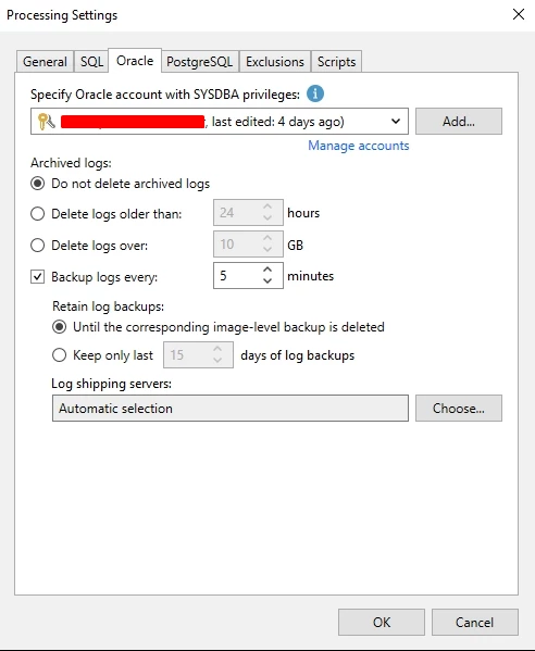

In the Oracle processing settings, we configured:
  • an Oracle account with SYSDBA privileges;
  • the option not to delete archived logs;
  • log backups every five minutes;
  • retention linked to the image-level backup;
  • automatic log shipping server selection.

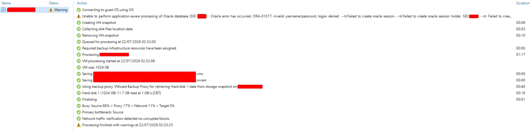

During the first execution, the VM backup was created, but Oracle processing finished with a warning:
ORA-01017: invalid username/password; logon denied
Failed to create oracle session
The guest operating system credential was working.
The issue was with the account Veeam used to open the Oracle session.
That account was not yet correctly prepared for the required processing privileges.
After the Oracle account was corrected, the image-level backup started completing successfully.

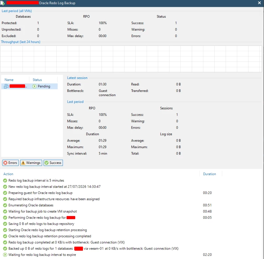

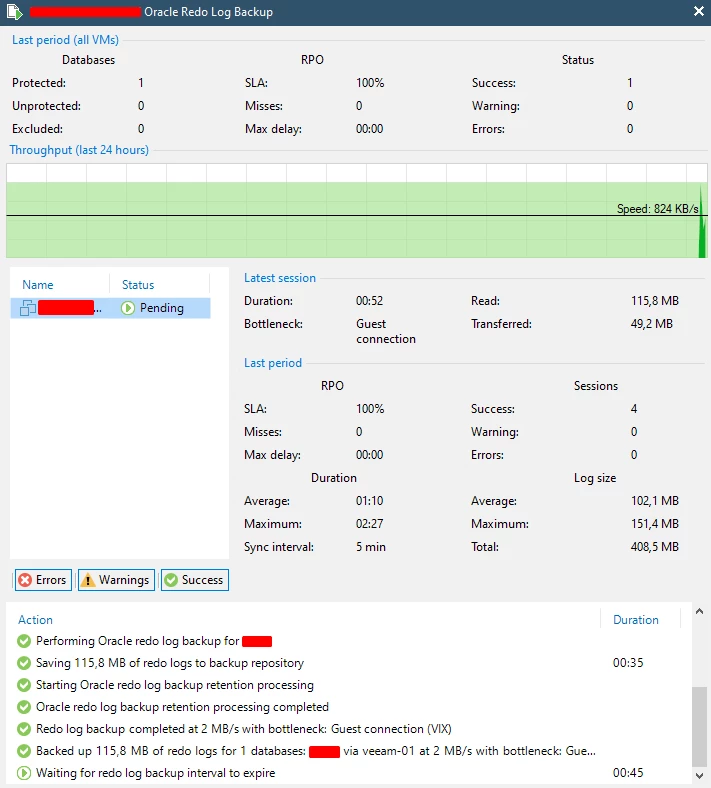

The job was green, but it transferred 0 B
The Oracle Redo Log Backup child job started normally, but it did not transfer any data.
The first message we saw was:
Collected redo log does not match any existing database backup: PEEM
Every session showed:
Read: 0 B
Transferred: 0 B
We created a new image-level backup to establish a fresh reference point for the logs.
After that, the mismatch message disappeared.
However, the main behavior remained:
Saving 0 B of redo logs to backup repository
Backed up 0 B of redo logs
This was one of the strangest parts of the case.
The job did not report an error.
It was shown as successful.
But no archived redo logs were being protected.
Looking only at the final job status was not enough.

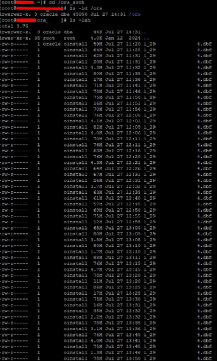

Were archived redo logs actually being generated?
The DBA confirmed that the database was running in ARCHIVELOG mode and provided the configured destination:
Archive destination    /ora_arch
We then checked the Linux server directly.
New files were being created continuously under /ora_arch, including files generated after the new image-level backup:
1_293638_1158103504.dbf  13:55
1_293639_1158103504.dbf 13:57
1_293640_1158103504.dbf 14:02
1_293641_1158103504.dbf 14:07
1_293642_1158103504.dbf 14:11
1_293645_1158103504.dbf 14:15
1_293647_1158103504.dbf 14:21
1_293649_1158103504.dbf 14:25
This test proved that:
  • Oracle was generating archived redo logs;
  • the files were stored in the path provided by the DBA;
  • the files remained physically available;
  • new logs were created after the image-level backup.
The problem was not a lack of log switches, and during this test the files were not being removed by RMAN.

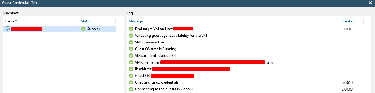

During the credential test, we noticed that Veeam first tried to resolve the VM hostname.
The name did not exist in DNS:
No such host is known
Because the hostname could not be resolved, Veeam automatically selected one of the IP addresses reported by VMware Tools.
The problem was that it selected an interface that reset the SSH connection:
Connected to 10.200.53.4
An existing connection was forcibly closed by the remote host
We tested each address separately.
SSH worked on:
10.200.52.2
192.168.3.199
SSH was reset on:
10.200.53.4
10.200.51.4
The hostname was then mapped to the management interface confirmed by the team responsible for the environment.
After the change, the Veeam credential test completed through SSH:
Connecting to the guest OS via SSH
Credentials and connectivity have been validated successfully for Network transport

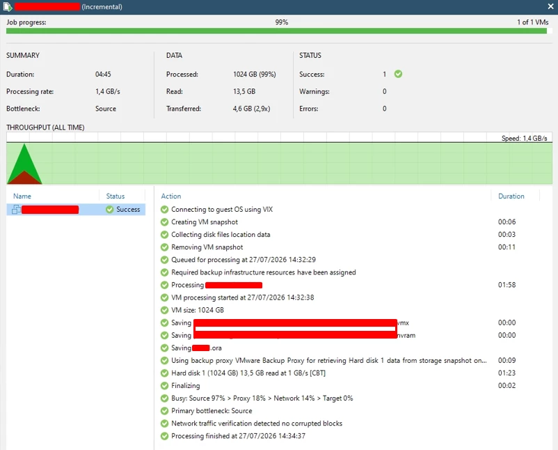

The account configuration was corrected in Veeam and a new backup was executed.
This time, guest processing finished successfully:
Connecting to guest OS using SSH
Saving PEEM.ora
Processing finished successfully

After read access was corrected, the redo log sessions started transferring data normally:
Saving 235.1 MB of redo logs to backup repository
Backed up 235.1 MB of redo logs for 1 database
After six sessions, Veeam reported:
Total log size: 1.5 GB
Warnings: 0
Errors: 0
The job was still green, but this time the data was actually being protected.

However, the account used for Guest Processing could not read the files under /ora_arch.
Veeam could identify the sequences, but it could not access the files to copy them to the repository.
After read access was corrected, the logs started transferring normally every five minutes.
