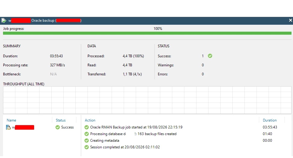

Normal job behavior

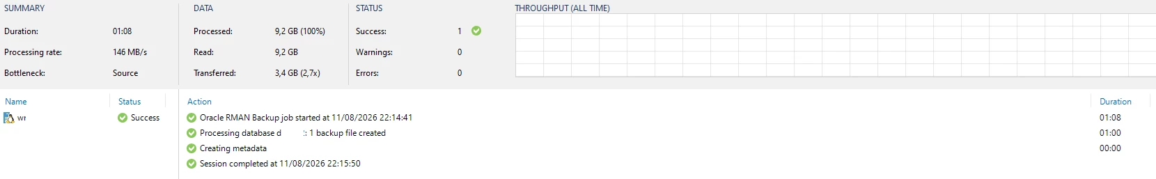

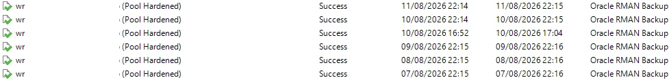

In the Veeam console, the backup session was reported as Success.
However, when I checked the execution directly through the RMAN script, errors were being reported.
This created a false positive.
From the Veeam console perspective, the session had completed successfully. However, RMAN itself was reporting failures during the operation.

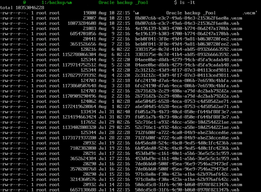

There was another important symptom: files were being created on the backup repository during the backup attempts, but according to the DBA validation, the files were not being populated with the expected data.
This was concerning because a successful-looking backup session does not necessarily mean that the resulting backup can actually be used for recovery.

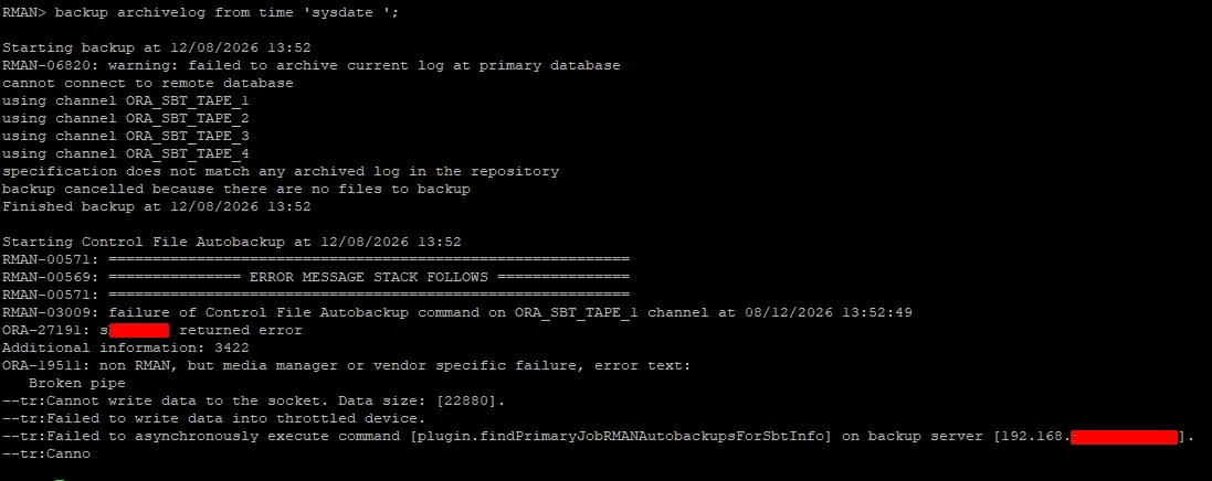

Looking at the RMAN logs

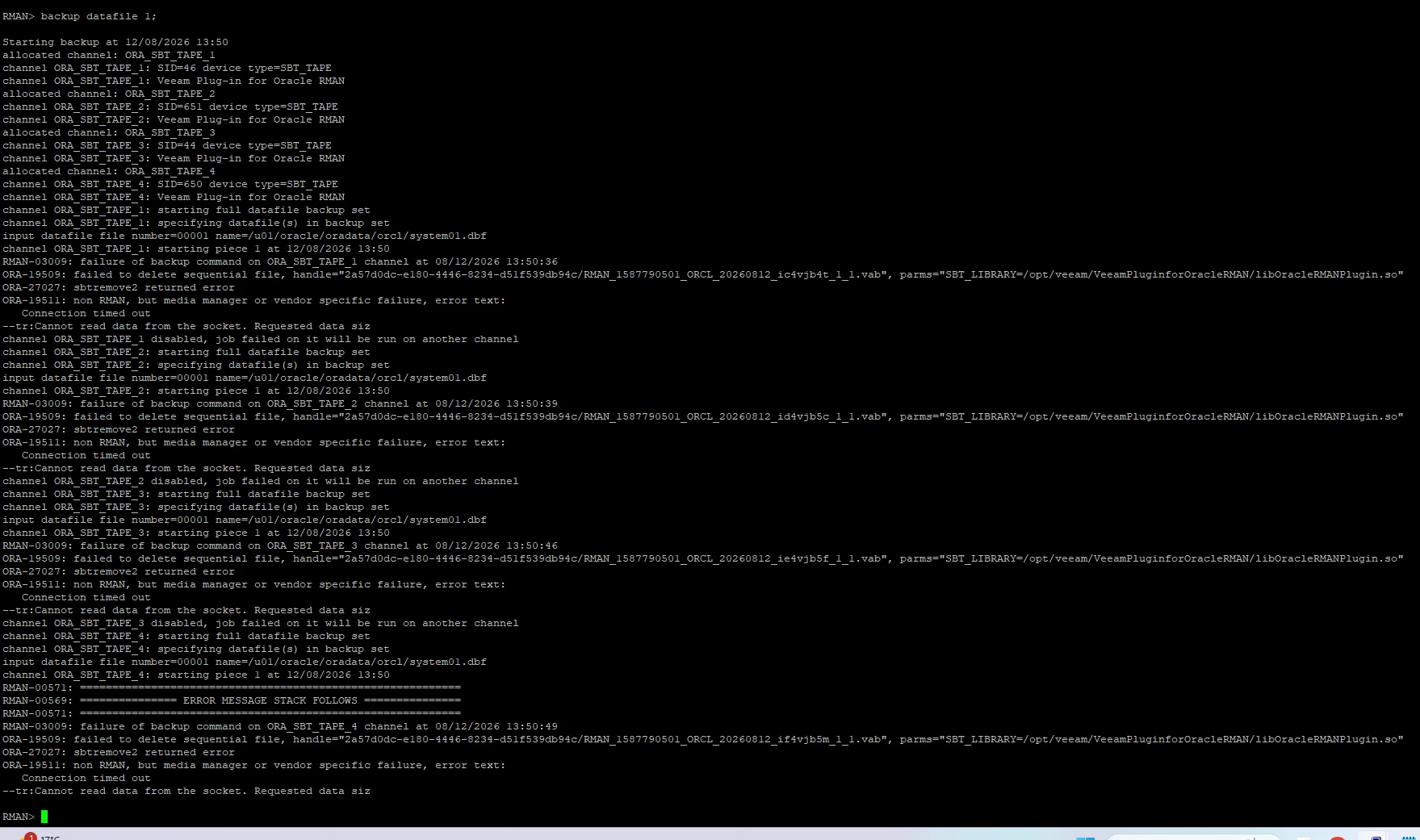

The RMAN logs showed several errors related to the media manager and communication between the components.
Some of the main messages included:
ORA-19511: non RMAN, but media manager or vendor specific failure
Connection timed out
Cannot read data from the socket. Requested data size: [...]
ORA-27207: sbtremovev2 returned error
failed to delete sequential file
There were also errors while processing the Control File Autobackup:
Broken pipe
Cannot write data to the socket. Data size: [...]
Failed to write data into throttled device
Another message that caught my attention was:
Failed to asynchronously execute command
[plugin.findPrimaryJobRMANAutobackupsForSbtInfo]
on backup server [192.168.X.X:XXXX]
The Connection timed out, Cannot read data from the socket and Broken pipe messages were particularly interesting because they indicated communication problems between components involved in the backup operation.
At this point, however, there was still no way to say exactly which component was responsible.

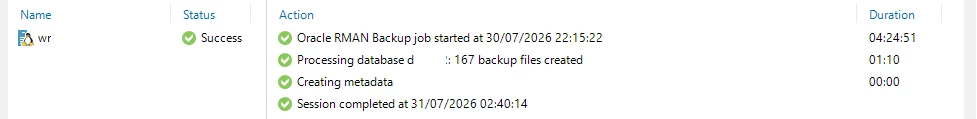

Datafile backup log
Archive backup log

As part of the investigation, the DBA tried to run a backup of only a single datafile.
Even with this much simpler test, the backup failed.
This was an important test because it helped rule out the possibility that the problem was specific only to the complete full backup routine.
If the problem had been related only to the full backup script or the number of datafiles being processed, a single-datafile backup could potentially have worked.
It did not.
This reinforced the need to investigate the communication between RMAN, the SBT interface and the Veeam Plug-in for Oracle RMAN.

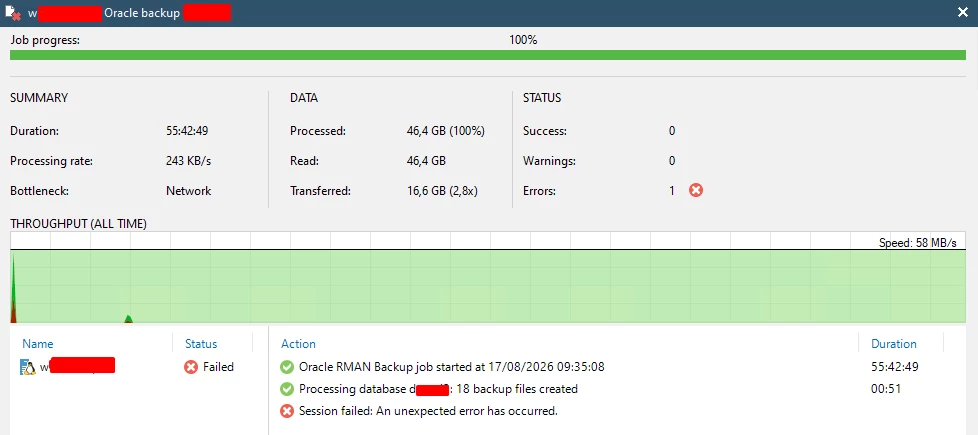

However, instead of returning immediately to normal behavior, the backup presented another issue.
When the backup would not stop
After the plugin upgrade, the backup started, but it remained running for more than 24 hours.
The job was not making the expected progress and would not finish.
I tried restarting the Veeam services and also restarted the services related to the plugin directly on the Oracle Server.
Even after these actions, the operation remained stuck.

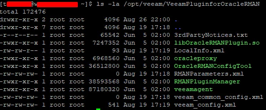

Finding the stuck RMANPluginManager
The next step was to investigate the processes associated with the Veeam Plug-in for Oracle RMAN.
I checked the plugin installation directory:
ls -la /opt/veeam/VeeamPluginforOracleRMAN
During this analysis, I identified the RMANPluginManager process associated with the stuck operation.
To release the process, I used:
killall -i RMANPluginManager
This stopped the process that was stuck and allowed me to continue with the troubleshooting.
This was a specific action taken during this incident to terminate the process that was no longer responding as expected. It should not be interpreted as a general recommendation to terminate plugin processes without first evaluating the active RMAN and Veeam sessions.
Looking deeper into the plugin installation
After stopping the stuck process, I decided that simply starting the backup again would not be enough.
I wanted to investigate the plugin installation itself.
During the analysis, I also noticed that the plugin package and RMANPluginManager were reporting different versions.
The versions observed were:
Veeam: 12.3.2.4854
RMANPluginManager: 12.3.1.1139
This was another relevant indicator, especially considering the communication errors and the behavior of the RMANPluginManager.
However, I could not confirm that the version difference alone was the root cause.
