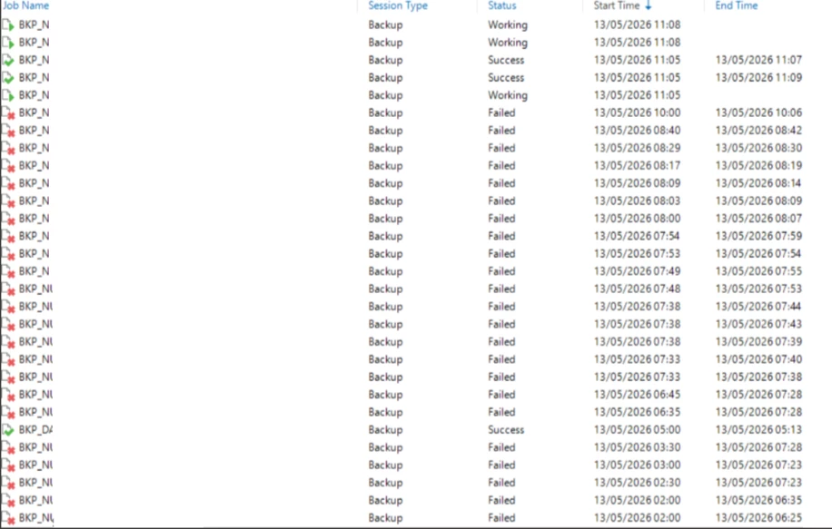

Failed to perform backup:
boost::thread_resource_error: Resource temporarily unavailable
Failed to upload disk '72f783a8-b305-481a-b4d7-52e3351ac6c0'
Agent failed to process method {DataTransfer.SyncDisk}.
At first, the messages related to the disk upload and the DataTransfer.SyncDisk method could suggest a storage, network, or data transfer issue.
However, after reviewing the affected sessions and the worker configuration, we identified that the failures were associated with insufficient compute resources available to the workers during a period of high concurrency.

During the affected backup window, multiple jobs started failing within a short period.
Some sessions completed successfully, while others reported the same resource-related error.
The issue was not isolated to a single VM or backup job. Different jobs failed while several Nutanix AHV virtual machines were being processed simultaneously.
The primary error was:
The backup session then reported:
The boost::thread_resource_error message indicated that the process was unable to obtain the resources required to create or continue one of the processing threads.
Because the same behavior appeared across different jobs, the investigation moved away from an issue affecting only one VM and began focusing on the shared processing components.

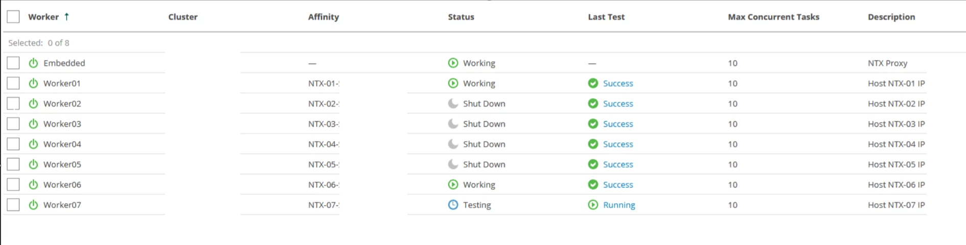

Reviewing the worker status
The next step was to review the Nutanix workers from the Veeam console.
The environment had eight workers, and their configuration tests were completing successfully. This indicated that VBR could communicate with the workers and that the general worker configuration was valid.
Some workers were displayed with the Working status, while others were shown as Shut Down.
This does not necessarily indicate a problem. Workers may be powered on when they are required for backup or restore processing and powered off when they are no longer needed.
The investigation therefore needed to consider more than whether a worker was currently powered on.
We reviewed the following points:
  • How many workers were processing tasks
  • How many jobs were running simultaneously
  • The maximum number of tasks configured for each worker
  • The CPU and memory allocated to each worker
  • Whether the failures occurred during the period of highest concurrency
  • Whether different jobs were reporting the same error
  • Whether the worker configuration tests were successful
  • Whether the Nutanix cluster had enough resources available for the worker VMs
Each worker was configured to process up to 10 concurrent tasks.
The task limit controls how many operations a worker is allowed to process simultaneously. However, it does not guarantee that the allocated CPU and memory will always be sufficient for every workload profile.
A worker may be configured for a specific number of tasks while still experiencing resource pressure depending on the type of workload, the volume of concurrent processing, and the overall activity during the backup window.

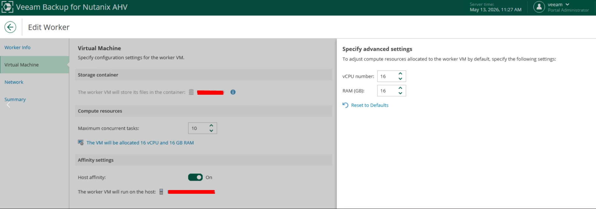

Increasing the worker resources
To provide additional processing headroom, the resources assigned to each worker were increased as follows:
Resource Before After
vCPU 12 16
RAM 12 GB 16 GB
Maximum concurrent tasks 10 10
The maximum number of concurrent tasks was not increased.
The objective was not to allow more VMs to be processed simultaneously. The objective was to provide more CPU and memory for the same maximum workload.
This is an important distinction because increasing the task limit without reviewing the available worker resources could create even more pressure during the backup window.
The final worker configuration was:
Maximum concurrent tasks: 10
vCPU: 16
RAM: 16 GB
The changes were performed through the Veeam console and planned outside active processing periods.
Changing worker resources, network settings, or affinity while the worker is transferring data may interrupt the operations being processed by that worker.
