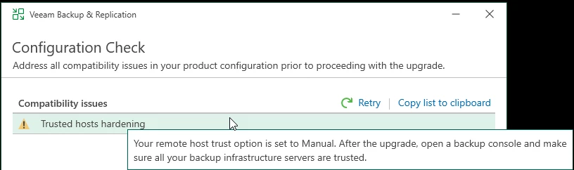

During the upgrade of Veeam Backup & Replication to version 13.2.29, I encountered the following warning during the Configuration Check phase:
Trusted hosts hardening
Your remote host trust option is set to Manual. After the upgrade, open a backup console and make sure all your backup infrastructure servers are trusted.
At first glance, this message may seem concerning, but it is important to note that it is not a blocking issue and does not prevent the upgrade from completing successfully.

Because the trust relationship must be verified manually, the upgrade validation process displays this warning to remind administrators to review trusted hosts after the upgrade.
Is the Upgrade Blocked?
No.
This warning is informational only and does not stop the upgrade process. The upgrade to Veeam Backup & Replication 13.2.29 completed successfully despite the warning.
The purpose of the message is simply to ensure that administrators verify the trust status of infrastructure components after the upgrade.
Depending on the environment, Veeam may automatically retain the existing trust relationships, but it is recommended to perform a quick verification.
