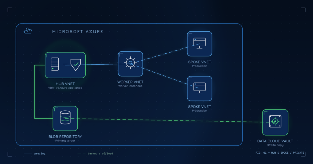

A while ago I was asked by an enterprise customer from Europe to design a Veeam backup solution for their Microsoft Azure environment. The setup was a classic Hub-and-Spoke architecture, and the goal was clear: leave the on-premises vSphere platform behind and run all workloads in Azure instead. Before any of that would happen, the customer wanted a proper backup design in place — built on Veeam Backup for Microsoft Azure (VBAzure) — so the new cloud workloads would be protected from day one.
The migration itself was not part of my engagement. My job was the design and, more relevant for this post, a deployment checklist the team could work through step by step to stand up VBAzure in a private, hub-and-spoke Azure environment. I have done a fair number of on-prem Veeam designs over the years, but a “cloud-first, private-networking-only” VBAzure deployment has a few specifics that are easy to miss if you only know the classic VBR world — private endpoints, DNS zones, worker placement and Disk Access being the usual suspects.

Phase 0 – Design decisions (fix these before you deploy)
  • Decide subscriptions:
    • Hub (shared services / VBR / VBAzure appliance)
    • Spoke(s) (production workloads)
    • Optional: separate backup or worker subscription
  • Decide regions:
    • One region per VBAzure appliance (recommended)
    • Workers deployed per protected region
  • Decide connectivity model:
    • Hub-and-spoke with VNet peering
    • No public IPs for VBAzure components
  • Decide offsite strategy:
    • Azure Blob only, or
    • Azure Blob + a separate offsite target (e.g. Veeam Data Cloud Vault)
  • Confirm private deployment is mandatory (no public endpoints)
Phase 1 – Azure hub network foundation
  • Create Hub VNet:
    • Subnet: backup-management (VBR + VBAzure appliance)
    • Subnet: (optional) shared-services
  • Create Spoke VNet(s) (per workload region):
    • Subnet: production
    • Subnet: (optional) private-endpoints
  • Configure VNet peering:
    • Hub ↔ every spoke
    • Allow forwarded traffic
    • Allow gateway transit (if ExpressRoute/VPN is used)
  • Confirm DNS strategy:
    • Azure Private DNS (recommended)
    • Central DNS hosted in the hub

Phase 5 – Deploy the VBAzure appliance (private mode)
  • In the VBR console:
    • Add the Microsoft Azure plug-in (if not already present)
  • Deploy the VBAzure appliance:
    • Connection type: Private IP
    • VNet: hub backup-management subnet
    • NSG: allow inbound TCP 443 from the VBR server only
    • No public IP
  • Appliance sizing:
    • In v8.1 only B2ms, F4s_v2 or F8s_v2 are selectable — start with F4s_v2, or F8s_v2 for large estates, and check the sizing guide
    • Resize later if needed

Phase 7 – Storage accounts & private endpoints
Worker configuration storage (per region)
  • For each worker region:
    • Create a Storage Account
    • Enable Blob + Queue
    • Disable public access
    • Disable soft delete
    • Default tier: Hot
  • Add tag:
    • Veeam Backup Appliance ID = <ID>
  • Create Private Endpoints:
    • Blob → worker VNet
    • Queue → worker VNet
    • Register in Private DNS
Backup repositories (per region)
  • Create a Storage Account for backups:
    • Same region as the workers (avoid egress cost)
    • Blob only
    • No public access
  • Create a Private Endpoint:
    • Register in DNS
  • Add the repository in VBAzure

Phase 9 – Worker configuration
  • In VBAzure:
    • Add a Worker Configuration per region
    • Select:
      • Worker VNet
      • Subnet
      • Storage Account
      • Profile (CPU/RAM)
  • Create custom worker profiles:
    • Based on VM size / disk count
    • Avoid defaults for large estates
