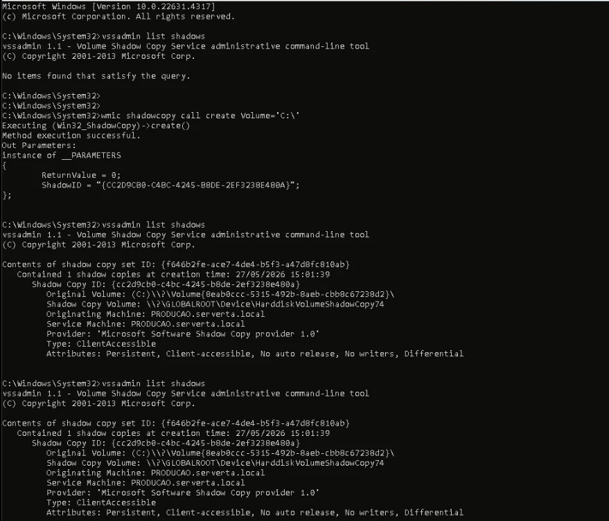

We also checked whether there were existing shadow copies:
vssadmin list shadows
The output showed no existing shadow copies:
No items found that satisfy the query.
Then we manually created a snapshot to validate the basic VSS mechanism outside the Veeam job workflow:
wmic shadowcopy call create Volume='C:\'
The snapshot was created successfully.
After that, we listed the shadow copies again:

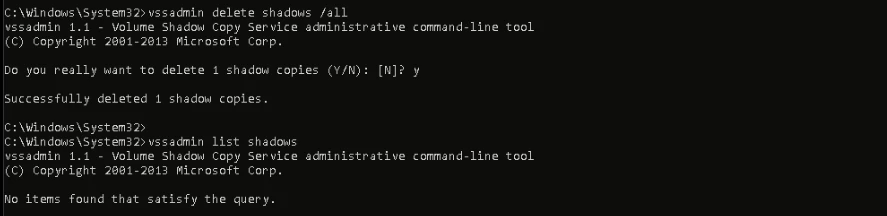

And deleted the snapshot:
vssadmin delete shadows /all
The deletion also completed successfully.

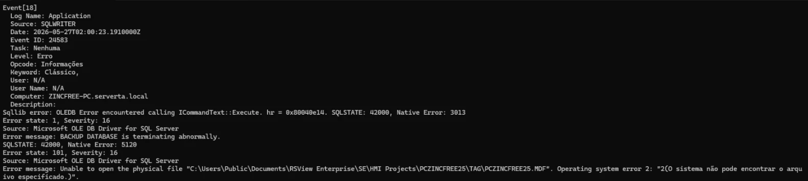

To check recent SQL Writer events, we used:
wevtutil qe Application /q:"*[System[Provider[@Name='SQLWRITER']]]" /f:text /c:20 /rd:true
At this point, the investigation started to change direction.
In the SQLWRITER events, we found a message similar to this:
BACKUP DATABASE is terminating abnormally.
Unable to open the physical file:
C:\Users\Public\Documents\RSView Enterprise\SE\HMI Projects\PCZINCFREE25\TAG\PCZINCFREE25.MDF
Operating system error 2:
The system cannot find the file specified.
This message indicated that SQL Writer was trying to access an .MDF file that no longer existed on the server.
At this stage, it became clear that this was not simply a broken VSS issue. SQL Writer was trying to validate an old reference during the freeze process.

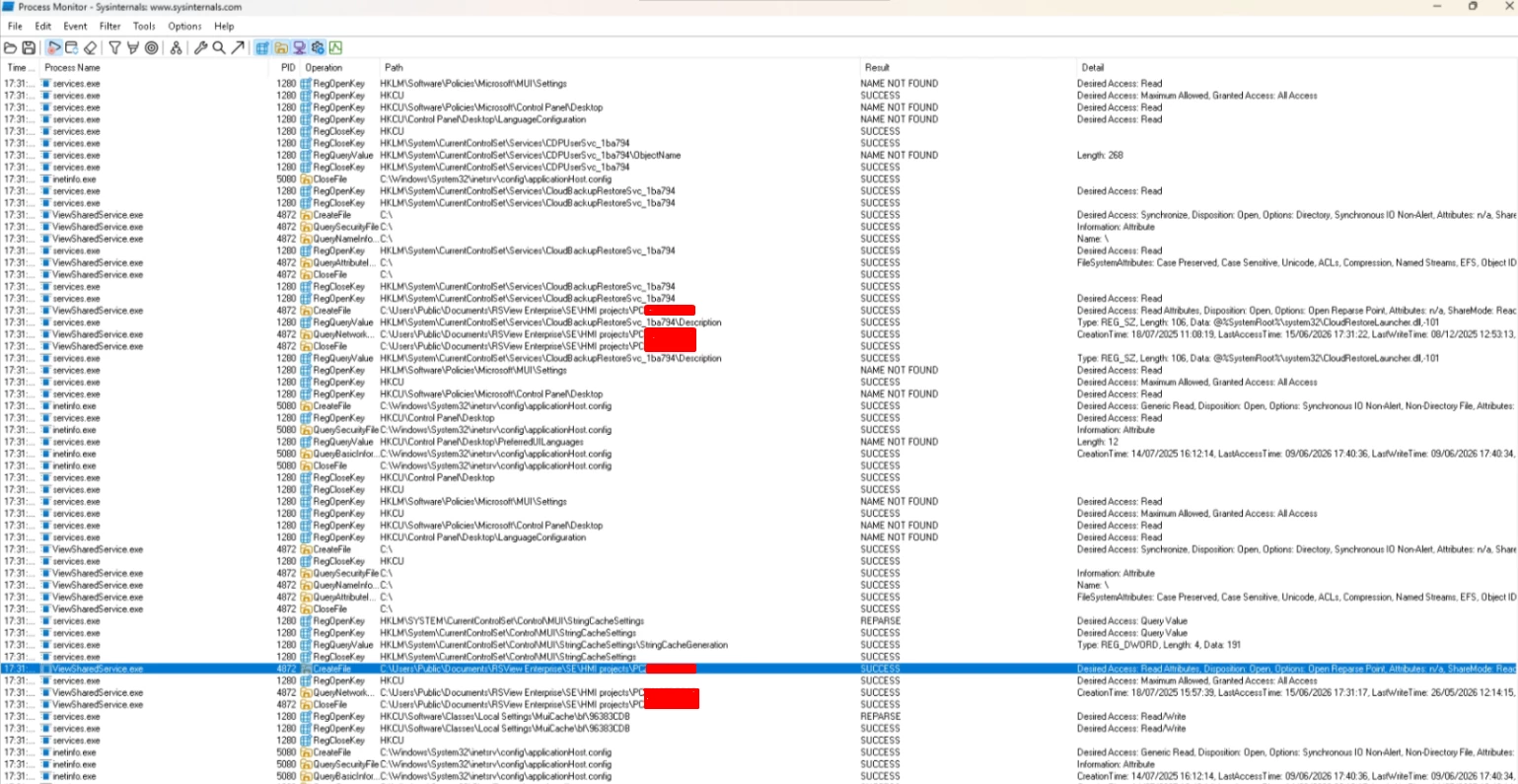

Confirming the issue with Process Monitor
After identifying in the SQL Writer events that there was an attempt to access missing files, we used Process Monitor from Sysinternals to confirm which processes were still trying to access those paths.
The idea was to filter access attempts related to the path shown in the error:
During the capture, we could see access attempts related to that old environment structure.
Process Monitor was essential to confirm that the issue was not directly caused by Veeam Agent. Veeam was only triggering the expected snapshot workflow. The failure occurred because SQL Writer still had old references to files that no longer existed.

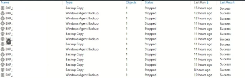

After cleaning up the invalid references that pointed to missing database files, SQL Writer stopped failing during the freeze process, and the Veeam Agent job started running successfully.
