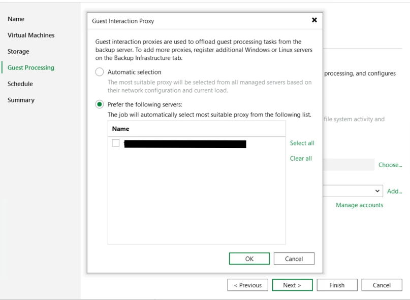

Guest Interaction Proxy
Based on KB you can use:
  • appliances - VSA, VIA
  • manage linux servers like RHEL/Rocky server with installed: libmsi1, samba-client, and samba-common-tools
  • windows to support group Managed Service Accounts (gMSAs)
If you have been used in credentials just username, this will fail, because Veeam uses now gPRC (Kerberos) and you need to define domain with user, otherwise you will get error like i had below :)
Linux GIP is not available
If you upgrade from v12 to v13, you wil be able to select widnows manage server

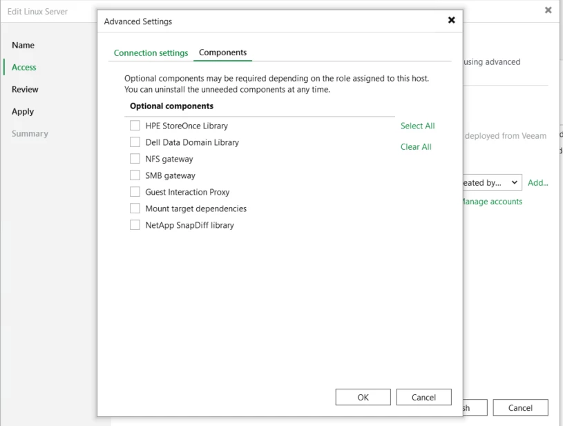

This could be changed by installation of GIP service on linux manage server - rhel/rocky 9.x
Log Shipping Server
This is interesting part
If you upgrade from v12 to v13, you wil be able to select widnows manage server and VSA,VIA appliances.
To apply linux log shipping server is needed to install guest interaction proxy role on it, what is described above. After that you can choose manage linux server as log shipping server.
