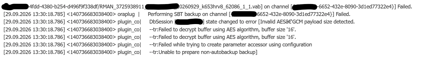

We had an unmanaged Oracle RMAN plug-in on SUSE Linux. It ran fine for a long time under VBR 13.0.2 and earlier with the matching plug-in version. We upgraded VBR to 13.1.1.18 and then updated the plug-in. The 13.1 plug-in also needs a new OpenSSL package, so we installed that and checked it as well. Everything looked clean.
The problem
After the upgrade, the RMAN backups failed. The plug-in could no longer talk to the backup server properly.

  • At the password prompt, press Enter without typing anything to keep the existing password. If you've typed something by accident, you can't see it because input is hidden. Cancel with Ctrl+C and start over.
  • If the wizard stops with Invalid AES-GCM payload size detected / Failed to decrypt buffer using AES algorithm while it reads the existing DB credentials, enter the credentials again instead of reusing the stored ones.
