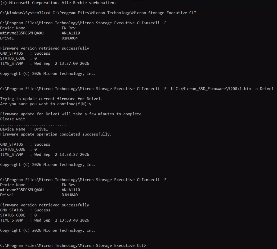

As flashing the SSD firmware was not possible through the RAID controller (LSI 540i), we had to pull every single of the 16 drives from each server while it being offline, connect them one after the other to a Windows PC via an USB/SATA controller and flash the February 2026 Micron firmware with the appropriate Micron tool:
Once booting the server with all drives back inside them, the system ran flawlessly and fast again. As if nothing had happened… ;)
